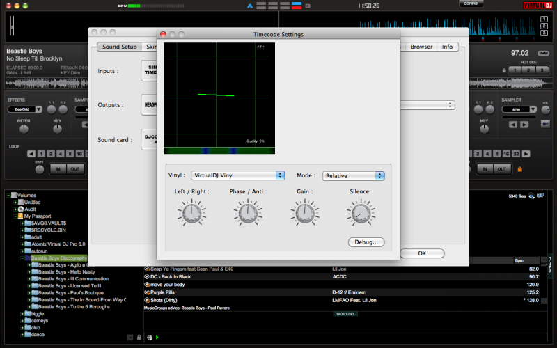

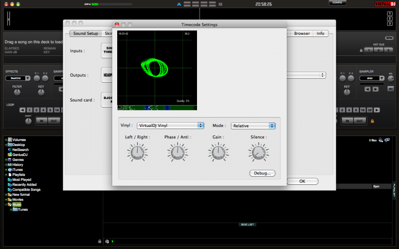

Huey,
I get it to work but after maybe a song or too i get this and when I Pause the track i get the track skipping all over, here are some ss
Could it be that my stylus is messed up not working properly
Posted Wed 31 Aug 11 @ 10:55 am

You got a bad signal coming from that turntable. Leave it on that screen and mess with the RCA, I bet you'll see the signal change shape. Or it could be a needle going bad. And when checking the cables don't just check the ends it could be in Tue middle of the cables aswell.
Huey
Huey
Posted Wed 31 Aug 11 @ 11:34 am

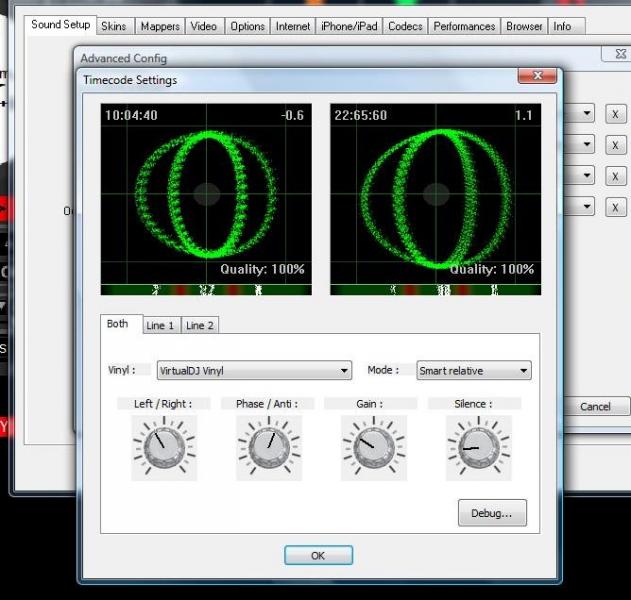

Hahaa! Ok DONT throw the turntables, I'll cry, J/K! Ok by the looks of it you need to turn the "Silence" up alittle more. Also use "Smart" not relative. With Smart when you drop the needle back to the beginning of the timecode the song will start over, when using Relative it'll just stay in the same spot no matter where you drop the needle.
Move those and let me know how it works
Huey
P.S. Dont get upset just take your time, when I went through all this it took me like 5 hours!! But in the end it was well worth it....
Heres how mine looks,
Huey
Posted Wed 31 Aug 11 @ 8:27 pm
