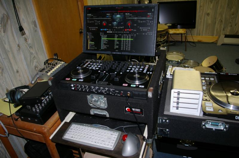

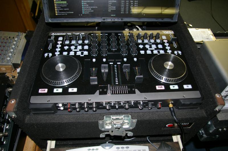

I just wanted to show you guys how slick this all went together.
The new deck that it sits on is 1/4" black starboard and the lid just fits.
You never know what kind of fit problems you will encounter, but this went in there skin tight all around.

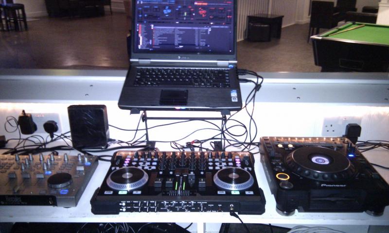

My first night out with the VMS4.
VMS4 in to club system via XLR's
RMX in to channel one of the VMS4 as VDJ backup
CDJ in to channel four as the analog backup
Both RMX and VMS4 were connected to the PC and mapped to VDJ simultaneously. I could have worked from either with the sound coming from the VMS4.
If needed I would have played a track on the CDJ, killed the VMS4 audio on channels two and three and switchd them to analog. Then changed the soundcard in VDJ to the RMX, turned up the fader and continued on that. However that wasn't needed in the end as the VMS4 lasted the night.
Cheers,
Roy
