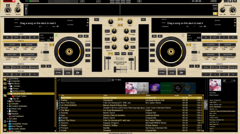

grazie per le risposte , senza togliere nulla a tutte le skin esistenti usavo la skin di cioce cue-rmx-v2.5 1366 x768 ..che uso ancora sulla vdj 7.4.1.
daro' un occhiata grazie

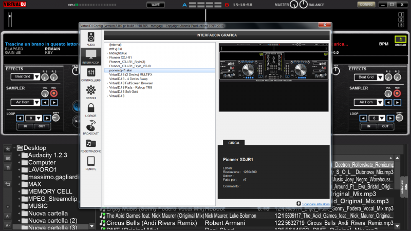

PERDONATEMI NON E' PER NIENTE.... MA QUESTA SKIN PER LA XDJ R1 PER VDJ8 GLI MANCA UN BEL PO' RISPETTO ALL'ORIGINALE PER LA 7 NON LA RIPRODUCE AFFATTO QUANDO INSTALLATA E FUNZIONA MALE. SE TANTE VOLTE .....DEVELOPMENT TEAM ...POTETE PROVVEDERE VE NE SONO GRATO GRAZIE install_pioneerxdjr1.exe

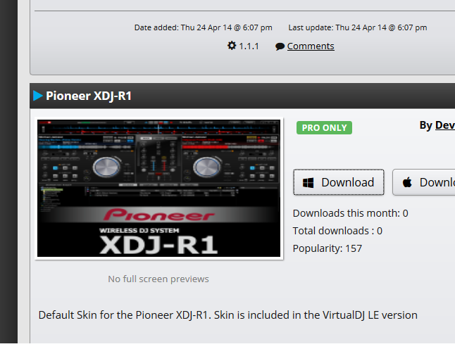

SKIN PER LA XDJ R1 TROVATA NELLE ADDONS PER VDJ 8 , SE SBAGLIO IO QUALCOSA CHIEDO SCUSA MA VORREI CAPIRE GRAZIE

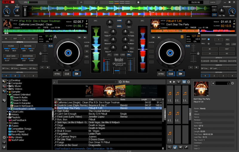

Update version 2,0
Added 2 Decks mode with mini decks
Added Sandbox
Remain time flash on end
Added Waveform color menu
Added Battery status
New Center panels
New Browser Icons
New Song Positions Progress bars - menu on the top
New Scratchwaves
http://it.virtualdj.com/plugins/index.html?addonid=16846

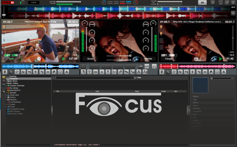

Nuova skin per Vdj8 per i video mixatori disponibile
djdad wrote :
Here is Focus. A dedicated Video skin (2 decks)
Every control is displayed on Screen with semi-transparent elements. A menu is offered to choose which elements you wish to see and which not.
The menu hides/shows from the top-right "eye" button.
Some custom buttons available at the center as well.
Download link : http://www.virtualdj.com/plugins/index.html?addonid=80060
Some useful actions/variables (e.g. if you want to map your F keys or create some custom setups with combinations)
toggle '@$options' (hide/shows the menus)
set '@$hc' 1 (shows HotCue points on screen)
set '@$hc' 2 (shows HotCue Info on screen)
set '@$hc' 0 (hides all HotCue Info from screen)
toggle '@$loopi' (shows/hides Loop Controls)
toggle '@$fxi' (shows/hides FX Controls)
toggle '@$fxsli' (shows/hides FX Sliders Controls)
toggle '@$pitchi' (shows/hides Pitch Control)
toggle '@$pitchinfo' (shows/hides Pitch Info)
toggle '@$bpmi' (shows/hides BPM Info)
toggle '@$controli' (shows/hides Deck Transport Controls)
toggle '@$decki' (shows/hides Times)
toggle '@$texti' (shows/hides Artist-Title)
toggle '@$vui' (shows/hides VU meters)
toggle '@$voli' (shows/hides Volume Sliders)
toggle '@$gi' (shows/hides Gain knobs)
toggle '@$filteri' (shows/hides Filter knobs)
toggle '@$eqi' (shows/hides EQ knobs)
toggle '@$cri' (shows/hides Audio Crossfader)
toggle '@$vcri' (shows/hides Video Crossfader)
toggle '@$vfxi' (shows/hides Video Effect)
toggle '@$vfxsli' (shows/hides Video Effect Sliders)
toggle '@$vtri' (shows/hides Video Transition)
toggle '@$vtrsli' (shows/hides Video Transition Sliders)
Thanks to Jason for his original idea.
PS. A nice surprise is waiting for those who dare to load an audio file :P
