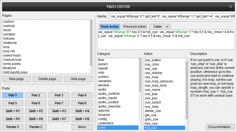

If you use VirtualDj 8.2 you can download the pretty much improved version of this code here:

PS: Neither launchpad or dicers are compatible with the new pads system on VirtualDj 8.2
However, you will be able to see the code through pad editor and copy the actions on your own mapper for the buttons you want:

Currently only controllers with 8 pads per side are remapped to support the pads system.
