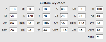

This image contains the Keyfinder custom codes which correspond to the Camelot wheel...
In the Keyfinder preferences I selected both (which writes the normal and Camelot key codes) and Overwrite the Comment tag.
It is important to tick the option "Write to tags/filenames automatically during batch jobs"
Also I ticked the parallelise option.
To use this program just select the songs for analysis, and "drag and drop" them into the Keyfinder window, then just press the Run Batch Analysis button.
