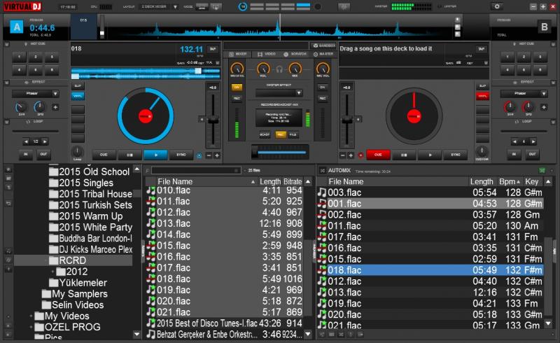

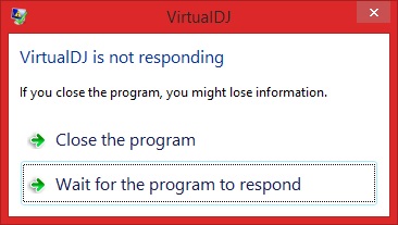

Build 2202.966 While recording set with Automix VDJ froze suddenly and shut down after Windows "Virtual DJ not responding" warning messages.
Screen picture during froze:
![](/image/40054/161168/vdj01.jpg)
Windows warning:
![](/image/97263/161169/vdj02.jpg)
Console: Pioneer DDJ-ERGO V
OS: Windows 8.1 64 Bit
CPU: Intel i7-3930K CPU @ 3.20 Ghz 3.60 Ghz
Memory: DDR3 16GB
RecordFormat: flac
REcordQuality: High
While playing on Automix I do not have any problem! Bug occurs only when recording on my pc.
Same set can be recorded after 2-3 attemps but causes waste of time.
