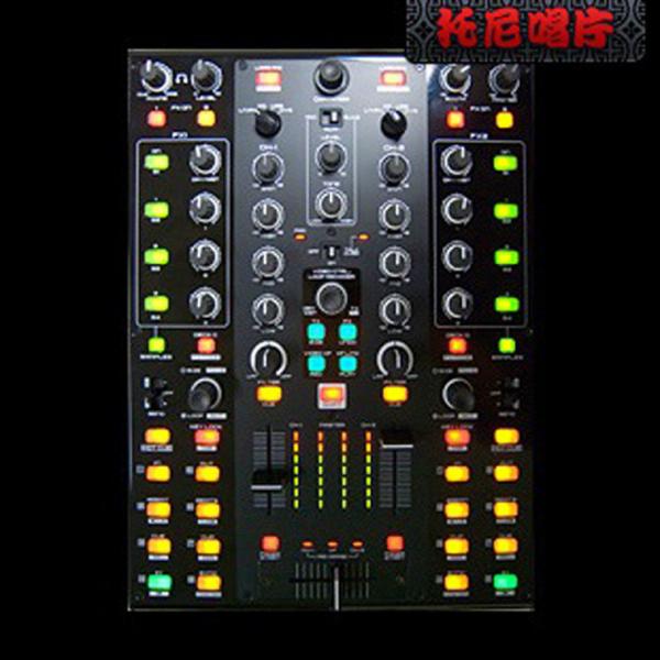

well with the vci400 they are mapped, but my timecode setup is hybrid mixer and i dont use the software mixer. My mixer is better for scratch style hiphop djing, but it has midi also..
Also when i say dont stop, example the loopout plug in is a mimic of hitting echo and having those echoes trail until it fade out. So if i start the trails and quickly load a track it wont cut off the trails...listen to my FB friend and pay attention to the echoe trail and still load a song
See how at 1:50, 2:50, 4:20, 6:26 before the trails have stopped he has already loaded a song on that same deck...thats what i mean by the trails not stopping.

Locodag ill try this on my VCI400 cause when i use my M70 i dont want to use the software mixer it cant handle what i do,Ill connect my vci400 tonight and tell you how it works.But i would rather have the effect just work,for now i use Loopout effect but it cuts the trails if i load a track before it finishes.
