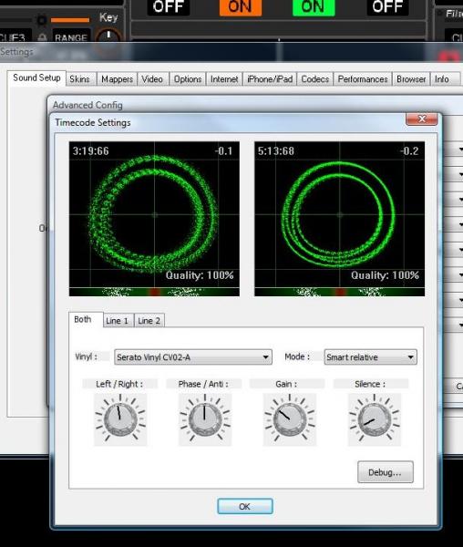

OK after some jacking around it seems the higher I turn up the gain. In the timecode window the more responsive. The problem with that is, I can no longer see the green circle. Soo am I missing something or do I just run it like that? Does seeing the green circles really matter?.

The size of the circle is a example of the needle cartidge volume output. If the circle is big, the cartidge volume is high and if its smaller, the output is lower. Before you raise the volume, Just make sure its perfectly round, then raise it. The circle is the left and right audio balance. If it works.. Thats good enough for me.

Just a silly question: Did you try to lower the silence volume knob on the timecode config window?
Ideally the gray cirlce should be as small as it gets without crossing the green circle when the vinyl is stopped (and the needle is on the vinyl).
You can try to lower it a little bit more, as soon as the deck keeps "still" when the vinyl is stoped.

I've lowered it but it still has some room to go down more so I'll try that tonight when I get home. Why I want it more responsive is because I usually set cue points when I'm cueing up the track. Sometimes I just use the mouse and move the scratch wave to where I want it. I can set cue points from my mixer so using the mouse defeats my purpose, lol!

Well Thanks Phantom, that seemed to help out alot. But I havent tried it live yet, only at home on my monitors.
timecode.jpg" class="bb-img">
What do you think?
