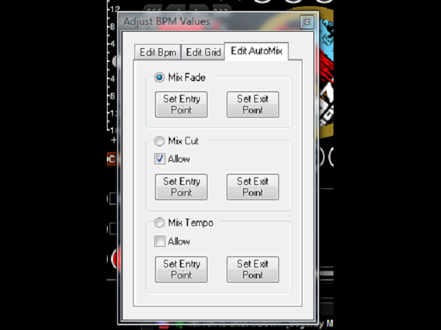

It's explained in the Manual about setting 'MIX' points for use with AutoMix modes. You can set 3 different IN and OUT mix points for the 3 different mix modes - Tempo, Fade, and Cut.
Cue Points are totally different and are not considered during AutoMix mode - that is why you don't see them and they are not used.

Thats what hes saying, you can make it start where ever you want. On my skin you just \"right-click\" on the bpm #\'s and a box shows up, look at the pic. You can edit the starts and mix points there as well as the beat grid when not in automix.
Hope that helps
Huey
