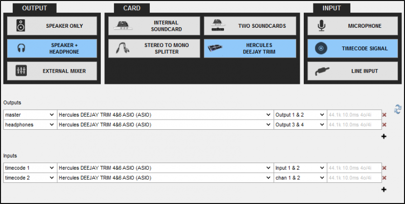

Select SEPARATE DECKS from the OUTPUT options, the Multi-Channel Soundcard to be used from the HARDWARE options and TIMECODE from the INPUT options. Not all cards will be detected in the HARDWARE options by VirtualDJ, but can still be used. If this is the case, use COMPUTER AUDIO from the HARDWARE Options. Once the Audio Setup is created select the multi-channel USB soundcard from the SoundCard field as well as assign the channels for all Inputs and Outputs. Click APPLY to save these changes.

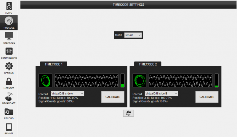

Once the Audio Setup with the Timecode Inputs is applied, an additional tab in the Settings will be available. Click on the TIMECODE tab to open the Timecode settings window.
VirtualDJ will auto-detect the Timecode being used and is auto-configured so there will be very few things to modify. In the rare case that the Timecode is not auto-detected, choose the type of Timecode from the drop down menu and VirtualDJ will auto-configure the necessary settings. Ensure that the Turntable or the CD player is running/spinning at the time of configuration.
Choose the timecode mode (Smart, Absolute, and Relative) depending on preference.

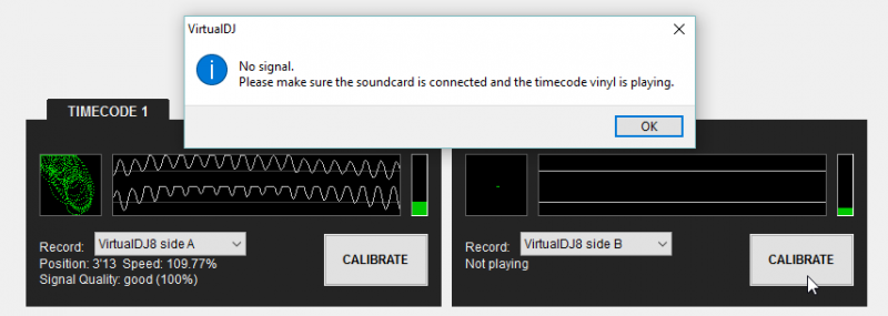

If a “no signal” or “timecode signal lost“ message pops-up, click on the CALIBRATE button to automatically detect the type of timecode after correcting any hardware related (stereo cable inverted, needle wired backwards, timecode not playing, cable disconnected, etc).

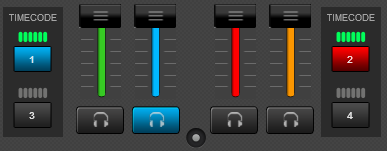

Timecode signal monitoring is achieved through the Custom Buttons panel on the Pro and Performance layouts. Clicking on the View Selection button inside the User Toggle will provide the ability to add Timecode & Line-In as a toggle selection.
Clicking on the toggle button will rotate through the selections chosen.
With Timecode active, the signal strength is displayed in the panel along with a Timecode Options button and an ON/OFF button.
Selecting the Timecode Options will provide a menu to quickly change modes from Smart, Relative, or Absolute.
Additionally, the options to open the Timecode Settings window, Bypass the timecode signal (use as a line-in) and reset the pitch on the deck are available for easy access.
