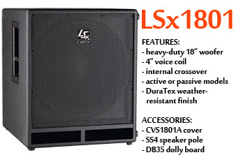

Get this. Really powerful and the price is really good..
https://www.carvinguitars.com/products/single.php?product=LSX1801
LSx1801 18" Subwoofer
LIST PRICE: $799.00
DIRECT: $399.99
System Type: 18-inch subwoofer
Speaker: Heavy-Duty 18" Woofer
4" voice coil
Power: 800W Cont. / 1600W Program / 3200W Peak
Recommended Amplifier Power: 1200W - 2400W
Impedance: 4 ohms
Connections: Neutrik™ Speakon & 1/4"
Top pole mount cup
Dimensions.: 23.5" high x 19.75" wide x 22.75" deep
Weight: 69 lbs
For the Powered Version
https://www.carvinguitars.com/products/single.php?product=LSX1801A
LSx1801A 18" Powered Subwoofer
LIST PRICE: $1,099.00
DIRECT: $579.99
System Type: 18-inch Powered Subwoofer
4" voice coil
Power: 700W RMS / 1400W Peak
Connections: 2 XLR (one M, one F), 1/4" input
Level control
Top pole mount cup
Weight: 77 lbs
LIST PRICE: $799.00
DIRECT: $399.99
4" voice coil
Impedance: 4 ohms
Top pole mount cup
Weight: 69 lbs
DIRECT: $579.99
4" voice coil
Level control
Top pole mount cup
Weight: 77 lbs

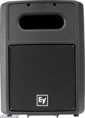

Hey, thanks for all those! I guess that's a no to the ev sb122 subs then (thought they looked too good to be true). I'll have a look to see if that carvin is availible here in the uk.

Yes, the EV sub122 sounds pretty good for a 12" sub. I also own a pair of Dynacord D12 passive speakers that I use with the Dynacord crossmax signal processor. I use It like a sattelite set in small venue 2 tops and 1 bottom. In bigger venues I use 2 tops and 2 bottoms. One bottom is the EV Sub122 and a Dynacord D-lite 2000 sub115 passive.
It Is a very light, mobile, agile and yet very powerful system.
If you need more info on It let me know!
Posted Wed 29 Oct 08 @ 1:24 am
djcity "Sorry dude, That sub is NOT the answer. Any sub that is in a cabinet designed for tops is gonna suck real bad. EV is a GREAT company that makes really good Pro grade speakers but those are NOT pro grade and will leave you real disappointed."
Don' t let the look fool you. It looks like the box of a top, but It Is actually a bottom design called High-Speed-Laminar-Vent Design. It has a tighter base response than a great deal of 15\" and 18\" subs out there.
The small EV Sub122 has a kick a$$$ sound you would not believe.
Posted Wed 29 Oct 08 @ 10:06 am
cerwin vega earthquake hands down the hell with all else
Posted Wed 29 Oct 08 @ 8:35 pm
Dydy1,
I hear ya man. They are not bad at all for what they are. I have heard them and used them.
They will add SOME low end to a system but can't boom it out like a sub in a LARGER CABINET.
The Cabinet will not allow for this sub to move enough air around to make a substantial difference. It just does not have the room to let the bass out.
It DOES give a nice tight punchy bass sound and it will complement a very small system but it does not really give nor is it able to produce the deep strong bass that some want, need or are looking for.

Hmmm, the plot thickens.
Like I said, space is an issue (and money) and I'm doing most Gigs with just a pair of the EV Sx200 tops at the moment. (And I quite like the sound to be honest). Maybe the Sb122 could be the answer to add a bit more kick.
Does the Sb122 have a high pass output so I could use it without a crossover?
