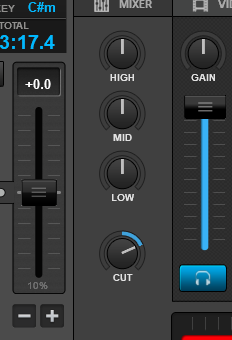

Can we please get a single knob cut plugin??
The one we have now basically requires 2 hands to operate!!

          It kind of already exists if you use the cut color fx (on the filter knob)

          Ok cool, I’ll try it.
Could you tell me the script to add it to a button on my controller, please??
