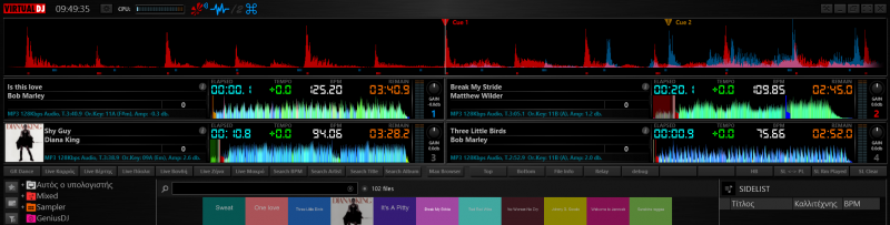

I am looking for a skin with less informations. What I just need are bigger waveforms. SilverSleek2 is close to but I made a photoshopped image to show my idea. Is it possible to make this with SilverSleek2 or does anyone know such skin?
http://fs5.directupload.net/images/160329/j5yfucgh.jpg
I agree with you here, I for one use my controller and dj mixers mapped with my most used functions...so i dont need a lot of stuff of onscreen.
PhantomDeejay wrote :
It is do-able. However your variation misses A LOT of mandatory stuff IMHO as I said in the other thread you started. Therefore I will take a look and see what I can come up with...
actually being able to totally disable the central section would be nice..just like the disable function in the rhythm wave. I think that would be a lot of work, would the decks have to extend and meet in the middle.
Also is there a way to map certain screen functions to keystrokes Like hold down V(iew) and L for view with sidelist in central view....V(iew) and S for sampler in central view or even on my controller and djmixer using my user buttons....

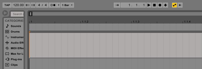

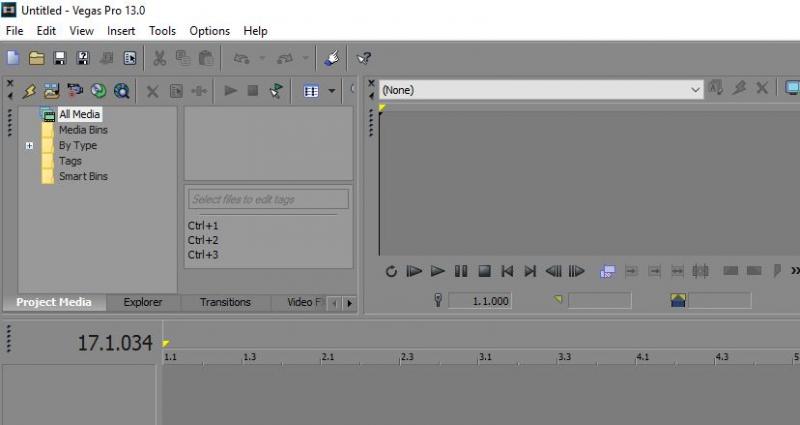

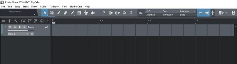

Also the bars counter on the progress wave should start count the first beat as 1.1 and not 0.1....that throws off the actual bar count a full bar.
Posted Fri 01 Apr 16 @ 6:23 am
That's a matter of personal taste... However the correct IS 0.1
The downbeat marker "marks" the start of counting. When you are on first beat after the downbeat you have traveled 0 bars
When you are on 5th beat that's when you have traveled 1 bar.
Your logic is different in a matter that you examine on what bar you are now, not how many bars have passed.
It's like 21st century where years count from 2000 to 2099, not from 2100 to 2199 :P

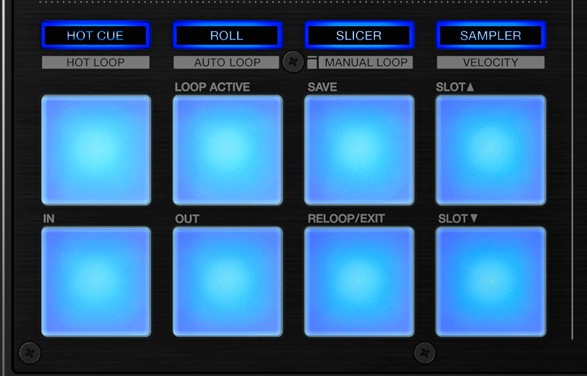

Would it be possible to get 'saved loops' added??
I asked some post ago but you answered everyone else's question and just skipped right over that.
You even have empty buttons which are actually supposed to be used for the saved loops function. My DDJ SP1 has the writing on the unit itself.
Hopefully you agree and add this to your skin.
Posted Fri 01 Apr 16 @ 10:26 am

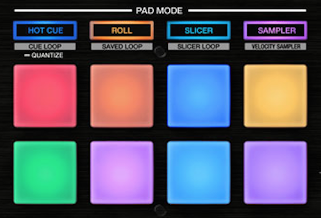

Saved loops are already there, just not for SP1.
SZ and SX2 have them (Right click on ROLL padmode button)
Posted Fri 01 Apr 16 @ 2:05 pm
Well I guess the layouts are pretty similar so I hope it all works.
DDJ SP1
DDJ SZ
DDJ SP1
DDJ SZ
Posted Fri 01 Apr 16 @ 3:01 pm

Well its not personal its music theory 101, you drop it on the 1 not the 0, songs are not made counting a zero as a beginning.
More-so its just your preference, it seems your using the digit scale of 0-9 as basis but that doesnt apply in music if it set up any music software beside yours, count will trail one bar, and for those of us that study the song structure of the songs we mix example I have a song that has a 4 bar intro and the first chorus starts at the 5th bar but if i look at you read out it says 4th bar. So the bar and beat counter music be in line with a sequencers beat and bar count..any software any score any sheet music there is no 0,1,2,3..its 1,2,3,4. This is Rule of Law in music...example below is studio one, vegas and ableton....all and anyone you search for yourself will be the same So if find any music software that differs please show me
Well I tried it using the SZ/SX and it doesn't work with my SP1 so I guess I have to hope you add it for the SP1 in a future release. In the meantime Ill just do without.
Thanks for the time......
Posted Fri 01 Apr 16 @ 11:16 pm

How should this work? You got to remap your SP1-Unit. Something like this (eg. for pad 1 in shift+roll mode)
factory default SP1 (called Group2_Pad1):
var_equal 'loopsize' 1 ? loop 0.03125 while_pressed : var_equal 'loopsize' 2 ? loop 1 while_pressed : loop 0.125 while_pressed
Replace with
and so on.
saved_loop 1 ? saved_loop 1 : loop ? saved_loop 1 : nothing
So if you hit shift + roll on your SP1 you have saved loops.
