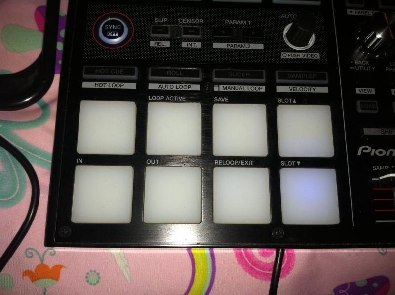

The SX skin works well, the only difference is the Manual loops. The button [in/out & reloop/exit] are placed differently..............Miss the scratch wave in the middle though. Maybe since well be using this skin with an external mixer or controller with with a mixer section, replace the mixer section with the scratch wave??
Humm u lost me here lol. The SX skin doesnt have any Loop In/Out buttons.

I know it doesn't but the pads do, lol!
