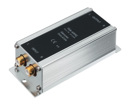

Although I could use a ground loop isolator, this is not an ideal when I am using 2 or more outputs.

[quote=djnanite]Although I could use a ground loop isolator, this is not an ideal when I am using 2 or more outputs.
It's probably coming through the USB ground - See above.
This is the best and most safest option. Or as above, you could try to obtain a compatible double-insulated power supply for the laptop.

The ground plane is passing from the laptop to the CDJ's. Your best bet would be to use 2 isolators.
http://www.radioshack.com/product/index.jsp?productId=2062214
Trying to bypass any grounding could cause damage to you or your equipment.
You could try an A/C voltage Isolator. I use one in my rack and it has cut out humm from one site that I have an issue with. Although it is another piece of equipment to carry, chances are your using a multioutlet pack anyway. My particular unit has 8 outlets.

Those ground loop isolators are no good if I'm using XLR connectors - it'd mean I'd have to isolate each input instead. If I'm running a 4 deck setup, then I'd need 4 ground loop isolators. That seems excessive, plus it means fiddling around with lots more equipment, and is yet another link in the chain that could fail. I'd really like to solve the problem at the source.

You can purchase XLR ground loop isolators, although these are more expensive than RCA phono ones. Search Google, eBay, etc. and you should find them.
If your using XLR, you could try using ground lift adapters or make your own cables that lift (disconnect) the ground on the XLR only.
