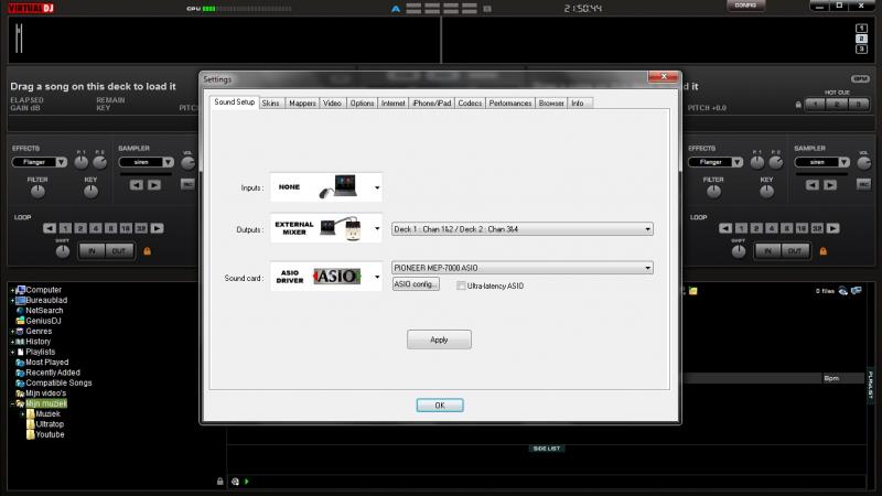

I had to download MEP 7000 drivers from the pioneer pro dj website before I could plug in my MEP into virtual dj - it works perfect with the latest version 7.x
you have to config your sound setup with ASIO drivers.

Soundconfigin VDJ 6,7:
Input: none
output : external mixer
Soundcard:Pioneer
Channel 1/2 left
Channel 3/4 right
greatings,Dirk
