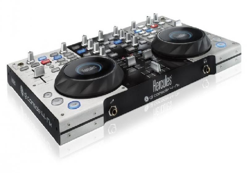

Can anyone share some knowledge on this controller, Do the headphones work using a two soundcard configuration using both ASIO & WDM, and any pluses or minuses on this unit..
Opinions Please....
Thanks,
Joey....
http://www.hercules.com/us/DJ-Music/bdd/p/141/dj-console-4-mx/
Opinions Please....
Thanks,
Joey....

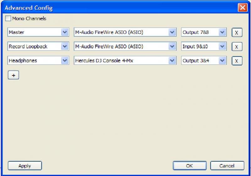

Ok, I picked up a new Hercules DJ Console 4-Mx controller today and set it up with new drivers downloaded from their site, followed the complete installation procedure, including a firmware update 4.07 everything went well with no problems...
I made sure my setup was correct in the config advance soundcard dialog using "WDM" Audio Mode in the control panel and to my surprise the headphones would not work at all PreListen or Mix , Is there something I'm doing wrong here.....
I'm using the 4-Mx controller for headphones only, My Master soundcard is my M-Audio NRV-10 (ASIO)..
Really need some help please....

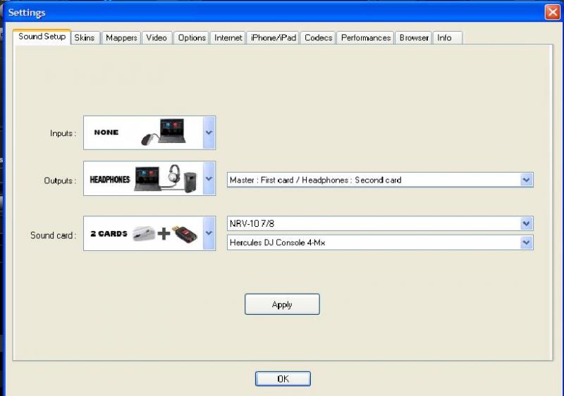

My Reply:
This obviously will work because you are using one soundcard for both outputs, Master and headphones, I did Not need to install VirtualDj DCE Ver. to make this work, I hooked it up as per your instructions and Yes it did work though the volume level was low...
I went ahead and tried the Outputs: Headphones Master: Chan 1&2 / Headphones: Chan 3&4, Sound Card: DJConsole 4-Mx One card, and it worked better, putting out more audio sound levels....
But I also tried the Two card config. Outputs: (Headphones) and Sound Card: (2 Cards) 1= NRV-10 As Master and 2= Hercules DJ Console 4-Mx For Headphone and it did Not work...This should have worked, But it Does Not Work at All...this is the most basic of configurations???
See attachment included.
I need My NRV-10 as the Master soundcard First, then the 4-Mx as the headphone....
This does not work...at All, No headphone signal in console.
