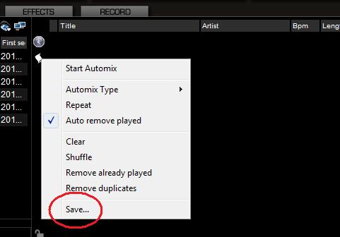

I would make a virtual folder before hand...you do that by first clicking the crate virtual folder button(bottom left) and just drag and drop your songs into the folder... after you do that all you have to do is drag that list to autoplay once the time comes..
Posted Mon 04 Apr 11 @ 10:43 am
Either that or simply drag and drop a number of tracks into the sidelist and hit automix...(",)

@John - Pionara has your best solution but missed one critical point. Once you have your playlist set-up in the sidelist, click on the paper icon and click save so that you have the playlist for future events and/or reference.
