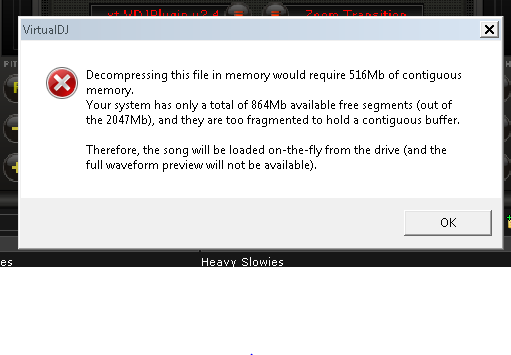

Running win7 32bit 4gb ram Dual 2.66hz cpu since installing VDJ 7, when loading a video file I often see this warning on the screen. The file can be big or small vob/mpeg it keeps appearing and does exactly what it says when I close it down, loads the file with no waveform and plays it.Although it doesn't effect the show from the dancers side, is there anything I can do/repair/upgrade to stop it happening???

For everyone that had the 'partial' waveform loading issues - this is why.
So, where everyone thought VirtualDJ had a bug that wasn't a bug; we are now supplying you with the information as to why only a partial waveform will be loaded.

This is not a bug, this is how it should work.
If you play videos, virtualdj will try to use ALL your available video memory for its internal calculations.
So if you have 2Gb of on-board video memory, the task manager will show virtualdj's memory usage growing up to 2Gb, it's normal.
You should also notice that the ammount of "free physical memory" in the task manager, is not shrinking ;)
If you get the "not engouh memory" message, it means that virtualdj doesn't have enough physical (non-video) memory to decompress the "audio" part of the song.
This message should happen if you load very long audio or video files (like 30mn long) and you don't have that much physical RAM.
That being said, on some computers, Windows and DirectX incorrectly report the amount of on-board video memory.
This results in virtualdj trying to allocate more than there is on the videocard, and the video driver ends up using real physical non-video memory instead. (and then you'll get the "not enough memory" very fast because the ram has been depleted by the video engine).
We put several watchdogs in virtualdj 7 to prevent this situation, but I guess it's still possible that it occurs on some computers.
If this is the case, 1) we're very interested in knowing your exact configuration (which video card / chipset, how much memory, which version of directX, what is written in virtualdj's registry entry "VideoMemFree"), and 2) you can solve the problem by using the registry value "VideoMemMaxUse" and set it to a little less than your real video memory size (in Mb).
