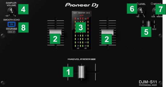

1 CROSSFADER
Blends audio and video between the left and right assigned Channels
Starts/Stops Deck when moved from one edge to any other position (Crossfader Start/Stop)
Requires Fader Start/Stop/Sync feature enabled from Preferences
2 VOLUME
Adjust the Output Volume of Left/Right Channel
Starts Deck when moved from minimum position to any other. Stops Deck at Cue point when moved from any position to minimum (Fader Start/Stop)
3 VU METER
Indicate the Pre-Fader output level of the Left/Right assigned Channels. The middle VU-meters indicate the overall Master Output levell
4 SAMPLER VOL
Adjust the Master Output of the VirtualDJ Sampler
5 CUE CROSSFADER
Blends pre-fader signals from Left/Right assigned channels to the Headphones Channel. When in left/right position, only the signal from Left/Right assigned channel will be routed to the Headphones Channel respectively.
6 CUE VOL
Adjust the Output Level of the Headphones Chanel
7 CUE MIXING
Blends audio signal in the Headphones Chanel between the Master Output (when in MIX) and the Channels depending on the CUE CROSSFADER position
8 SMOOTH ECHO
Enable/disable Smooth Echo. When enabled, an Echo Effect will apply when a Channel Volume fader is moved to minimum position or Crossfader moved to the opposite direction
When enabled the selected Hardware or Software Effect will apply to the VirtualDJ Sampler
Additional note
  • The entire mixer section of the unit is Hardware operated. The VirtualDJ internal mixer is not used, even thought the knobs on the GUI follow the actual ones (fake mode)
