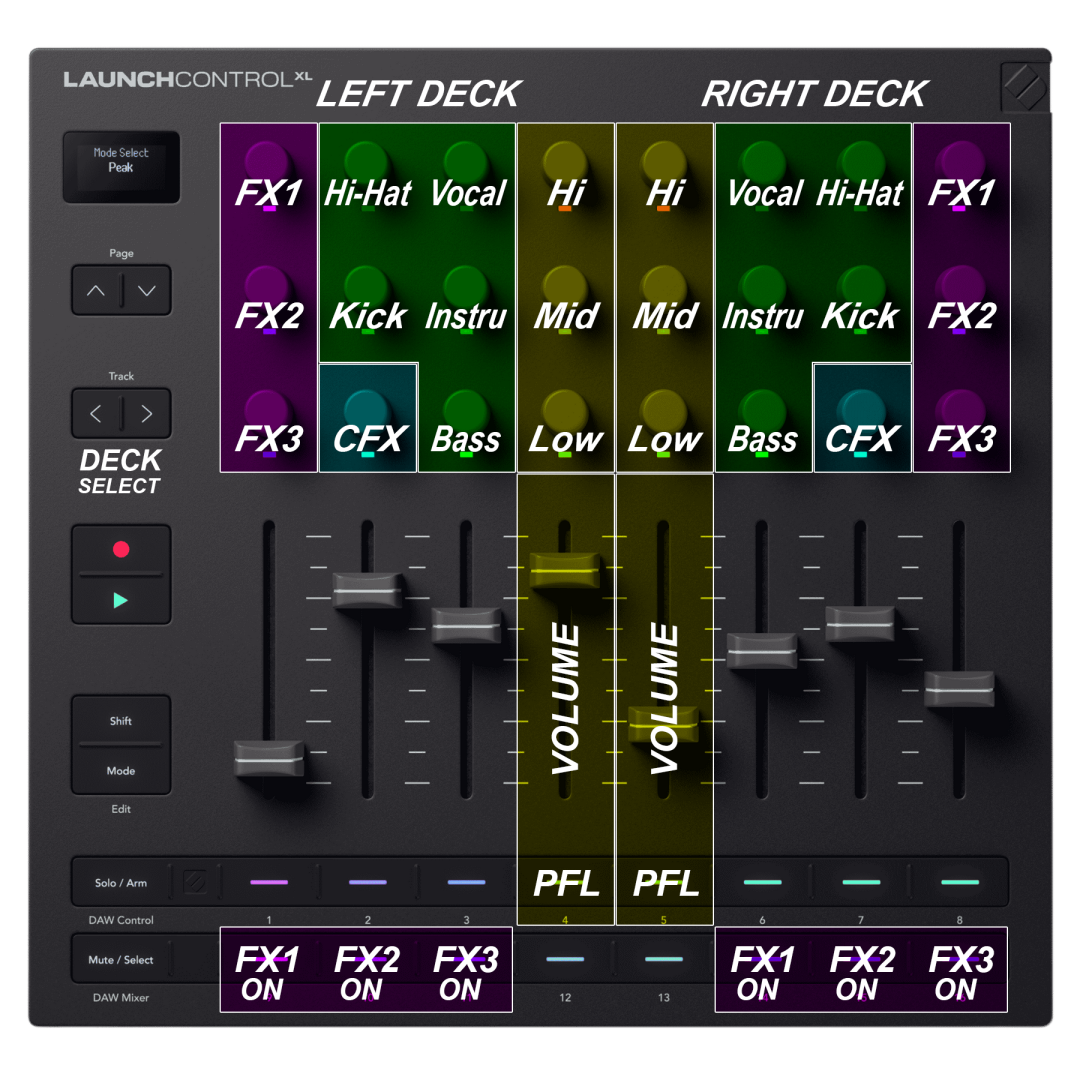

DAW MIXER
  • Press the MODE button once.
  • Press the "DAW Mixer" button once.
  • Press the MODE button once again.
The unit is now in "DAW Mixer" mode
This mode is pre-mapped to simulate an advanced mixer allowing you to control Effects, EQ, Stems and Volume for Left/Right Decks:
  • The 3 FX encoders control the 1st parameter of each of the 3 effect slots of the assigned deck.
  • Press the LEFT "Track" button to switch the left deck between decks 1 & 3
  • Press the RIGHT "Track" button to switch the right deck between decks 2 & 4
