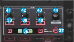

EFFECTS
  1. FX CH ASSIGN (per Deck). Use these buttons to clone the effects from the corresponding deck to the current left or right deck.
    The FX units 1 and 2 will apply the selected/triggered Effects to the left and right deck respectively.
  2. BEAT TAP. Manually adjust the tempo of the song. Tap this button at the same tempo as the track to help the software detect a different BPM reading (if needed).
    Hold SHIFT down and then press this button to set the left or right Effects unit to Single or Multi Effects mode. The Led of the TAP button will be on in Multi Effects mode to indicate the selection.
    Note. If the default skin is used with VirtualDJ 8, the Effects section will change according to the mode to offer 1 or 3 FX slots.
  3. FXON 1 button
    In Single FX Mode, press this button to trigger the selected Effect.
    In Multi FX Mode, press this button to trigger the selected Effect on FX Slot 1. Hold SHIFT down and then press this button to select the next Effect for FX Slot 1.
  4. FXON 2 button
    In Single FX Mode, press this button to control the Effect button 1 of the selected Effect (if the Effect offers one)
    In Multi FX Mode, press this button to trigger the selected Effect on FX Slot 2. Hold SHIFT down and then press this button to select the next Effect for FX Slot 2.
  5. FXON 3 button
    In Single FX Mode, press this button to control the Effect button 2 of the selected Effect (if the Effect offers one)
    In Multi FX Mode, press this button to trigger the selected Effect on FX Slot 3. Hold SHIFT down and then press this button to select the next Effect for FX Slot 3.
  6. FX 1 knob.
    In Single FX Mode, use this knob to select an Effect.
    In Multi-FX Mode, use this knob to control the 1st parameter of the selected Effect on FX Slot 1. Hold SHIFT down and then use this knob to control the 2nd parameter of the selected Effect on FX Slot 1.
  7. FX 2 knob.
    In Single FX Mode, use this knob to control the 1st parameter of the selected Effect. Hold SHIFT down and then use this knob to control the 3rd parameter of the selected Effect.
    In Multi-FX Mode, use this knob to control the 1st parameter of the selected Effect on FX Slot 2. Hold SHIFT down and then use this knob to control the 2nd parameter of the selected Effect on FX Slot 2.
  8. FX 3 Knob.
    In Single FX Mode, use this knob to control the 2nd parameter of the selected Effect. Hold SHIFT down and then use this knob to control the 4th parameter of the selected Effect.
    In Multi-FX Mode, use this knob to control the 1st parameter of the selected Effect on FX Slot 3. Hold SHIFT down and then use this knob to control the 2nd parameter of the selected Effect on FX Slot 3.
  9. BEATS Encoder. This encoder moves forward/backwards the track by 1 beat. Push the Encoder to show/hide the FX GUI of the selected Effect (of slot 1).
    Hold SHIFT down and then use the encoder of the left side (FX1 unit) to select a Video Transition. Hold SHIFT down and then push the left encoder to trigger the selected Video Transition.
    Hold SHIFT down and then use the encoder of the right side (FX2 unit) to select a Master Video Effect. Hold SHIFT down and then push the right encoder to trigger the selected Master Video Effect.
