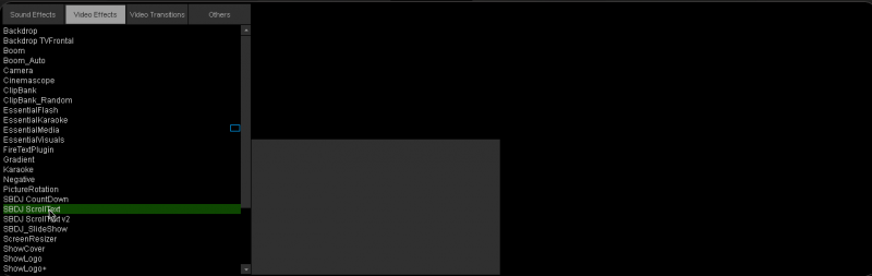

I don't know why or how, but I've seen this crop up both with win8 and win8.1. but only on my home computer
I re-installed directx runtime thing (even tho micro$oft says you don't have to) and the plug-ins and they went back to being usable. has never happened with work computers which are all win7. just win8. coincidence?

I had the same problem but was able to fix it. Although I really don't know what exactly was the problem and I'm a little bit confused now.
First some technical details:
System is a Asus Ultrabook with i5 and up-to-date Win 8.1.
Now the story:
Because Scrolltext v2 kept crashing my system I decided to run v1 again.
But after installing I couldn't see any button or sliders (like in the picture DJ Lucky Luciano postet above).
So I made sure I have installed every C++ runtime environment ( I know, I needn't, but why not).
Reinstalled DX 9 again, just to make sure, even though I did that a week or two ago.
Restarted and checked VDJ. Still no working plugin.
Checked in system32 and systemWOW64 that the file d3dx9_42.dll is actually there. It was.
So i decided to try every d3dx9_42.dll of every DX redist I could find at: http://www.microsoft.com/en-us/download/search.aspx?q=directx%20end-user%20runtimes
I started with the newest to oldest. Extracted the packages, exctracted the cab files and manually copied the .DLLs to their particular paths. Between copying and testing I restartet my system. No luck. The plugin won't work.
Reaching the DirectX End-User Runtimes (November 2008) package I stopped doing this, as it seems, d3dx9_42.dll first appeard with the DirectX End-User Runtimes (August 2009) package.
I nearly gave up, but had that stupid idea to ask RobRoy if he could send me his .DLLs, because he has the plugin working on his Win 8 laptop.
Luckily he sent me the files just a couple of mins later (thanks again Rob!) and you know what... copied them, restarted system, started VDJ and the plugin WORKS!!!
Here I'm... confused and I totally have no idea why it is now working???
So, Scott... any idea?
If you'd like I could sent you the working and a not working dll. Maybe you could tell the difference between them and check your plugin why it's working with one and not with the other.

Ok, this is really weird...
But at least I'm now able to tell what went wrong.
Here the solution:
Somehow, and I don't know why, both .dlls get into the wrong directory.
Analysing the DX redist packages shows that in cab Aug2009_d3dx9_42_x86 is a 1.8 MB DLL. (32bit version)
and in cab Aug2009_d3dx9_42_x64 is a 2.36 MB DLL for 64 bit systems.
The installation routine of DX setup puts this files into the "correct" folder. x64 to syswow64 and x86 to system32.
But that way the plugin won't work.
So I just copied d3dx9_42.dll from sysWOW64 into system32 and the other way round the dll from system32 into sysWOW64...
That's it... and that's also exactly the filestructure what Rob sent me...
I don't know why the two d3dx9_42.dll are of different size and what exactly the do, but that and the following is the problem:
http://en.wikipedia.org/wiki/WoW64
So, in theory, it would be possible to just copy the file from system32 to sysWOW64, but I did not test that.
My assumtion: The plugin is either using hardcode path to the file or doesn't use the right system path variables.
Or something is wrong in Win 8(.1)...
Is this possible?

Quote :
SysWOW64 is where 32-bit DLLs go. I've just checked, my d3dx 32-bit DLLs are in SysWOW64, and my 64-bit DLLs are in System32 as expected and the plugin works fine.
There are no hardcoded DLL paths in my plugins and no use of environment variables either - the OS usually directs to the correct file location. You only ever specify a path if you preload and I never do that. In any case if the 64 bit DLLs where in SysWOW64 then even preloading them would fail.
I've not come across this issue on any of my 64-bit windows 7,8 or 8.1 machines.

this is how the plugin show for me on my mac. can anyone help me to get this working please? thanks
DJ Lucky Luciano wrote :
if i click on it
it looks like that its not there no information of the plugin
no buttons, nothing
no buttons, nothing
