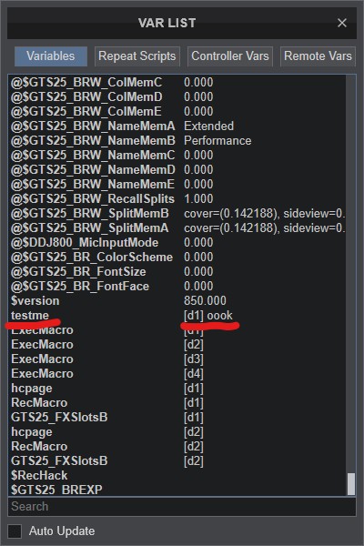

It does work fine here.
Please note that since you're using a "local" variable, the variable is set on default deck, which upon startup at least is deck 1
<onload action="set_var &apos;testme&apos; &apos;oook&apos;"/>
Aaah, no <oninit /> and <onload /> keys are not valid for VIDEO skins.
