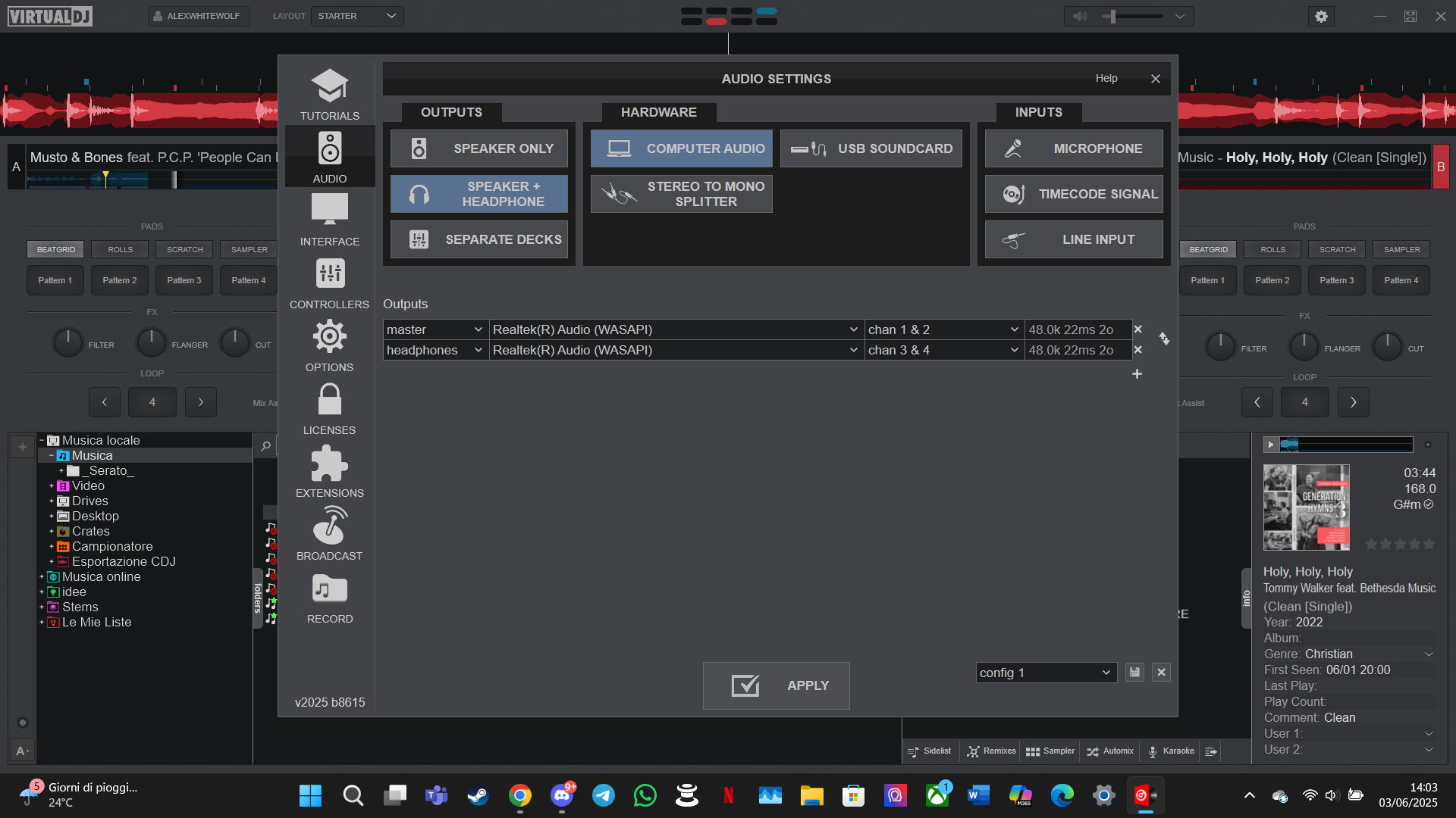

I'm currently using my backup controller, a Numark dj2go2 touch, and i'm trying to use my laptop speakers with it, but despite making sure that VirtualDJ is using them (i was even asked when i opened up the program itself if i wanted to use those) no sound comes out. What am i missing here ?

Can you post here a screenshot of your VirtualDJ Audio setup ?

Here, this is what it looks like
also yes, i made sure the master volume was 100% up
.png)
Posted Tue 03 Jun 25 @ 12:10 pm
I just noticed i took the screenshot after i lowered the volume back down a bit, but yes, i previously put it at max and still nothing

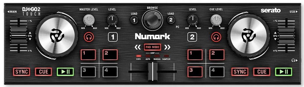

Ok, problem solved, i'm an idiot and i didn't notice there were extra volume knobs for both individual music, and they were both turned down by default. Now i can finally start mixing with this little thing.
You mean the channel faders in VDJ? Otherwise, where were they?
Posted Tue 03 Jun 25 @ 2:01 pm
Probably the "level" knobs above the deck number.
Posted Tue 03 Jun 25 @ 2:04 pm
