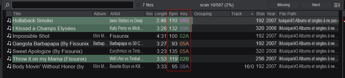

Just to illustrate my point:
Here's a screenshot showing an ongoing track analysis, where BPM and Key are already analyzed. So what stands the "etc" for in Analyze for BPM etc?
Thanks for taking my question under consideration 🙏

could be that it pulled bpm & key from tags before being scanned.
Posted Tue 13 May 25 @ 2:33 pm
This makes sense. It's possible indeed.
This involves that there is some internal flag somewhere saying "this tracks requires re-analyzing", and I would be happy to access in my filter 😉
Posted Tue 13 May 25 @ 4:08 pm
scanned=0 should do that
I see you used 'false' in your original filter, but I'm not sure if that actually works

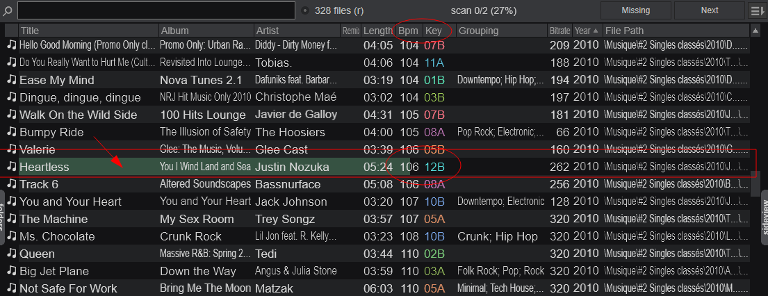

UPDATE:
1. I added "My library" add-on
2. I went to my music root folder and launched "Batch/Add to search DB", just to be sure nothing would be missing
3. I checked the "My Library/Database/Tools/Not Scanned" and found nothing but online tracks.
4. I move to some folders and still find some (not recent) files being re-processed
Posted Wed 14 May 25 @ 10:21 pm
Perhaps they were used with VDJ7?
If so they would have been scanned with VDJ7, but will be rescanned since the scanning has improved since.
Posted Thu 15 May 25 @ 4:35 am
That's possible.
Saying this, I'd like to mention that this is just disturbing for me, not at all for the performance: these unexpected scans are quite fast and happen seamlessly.
Posted Thu 15 May 25 @ 8:29 pm
