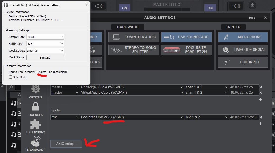

user30530383 wrote :
Thanks a lot Klaus, it works ! Unfortunately the latency is extremely (about 1s) ? Can I reduce it ?
It depends on the driver (which is usually also where you set it in a small ASIO config window)
And also if the sample rates match, so you don't have constant conversions
For instance if this gives you a good enough audio quality, the latency should "only" be around 15ms
That sounds pretty much instant to me - although if you were a drummer recording your drumset and had in-ear monitoring while playing, it would most likely be too slow. But for speaking it's fine:
