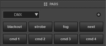

What I am trying to achieve:
After many failed searches, can anyone point me in the right direction, or advise if even possible, to code a pad which will take the current active deck bpm and send it to the Freestyler scene speed?
To prove the comms between Virtual Dj and Freestyler, setting the pad section in Virtual DJ to DMX, I can get the pads to activate CUE’s in Freestyler to the desired pad press (Blackout / Strobe etc) so we know this is working.
Visual achievement:
Within Virtual DJ
if deck 1 has a playing BPM of 130.
I would like to be able to single press a pad (let’s say ‘cmd 1’ for this instance) and the BPM of that deck is sent to Freestyler scene speed.
Within Freestyler
Column 10 in the CUE page is set to show as BPM.
I can get this (10) to update if I code a Virtual DJ pad to ‘tap sync’ (22) in Freestyler. The problem being is that this needs multiple taps to get relatively close to the current BPM, but, steps eventually run noticeably out of sync as this is not very accurate – my trialed example – Virtual DJ was playing at a BPM of 118, after several presses on the pad inline with the beat grid, Freestyler would set it to 120 or 115 etc….

However, with a further evening of trail and test, I have achieved!
The issue was found to be that a Freestyler Extension had to be activated and 'send beats' turned on.
FIX
Install the following extension from -
Settings > Extensions > Effects > Other > Freestyler
Switch the layout to master mixer and select the master effect to be freestyler (4), then select the options (cog) and set send beats to 'on'.

Track is playing, lights are flashing to the said BPM, multiplier set to 1, could I code 2 pads (on the DMX pad page) so that i can multiply by 1 on each press and another that divides by 1?
I find this can be added but as a one off increase per pad...
i.e. pad 5 = divide by 2, pad 6 = divide by 1, pad 7 = multiply by 1 (normal operation), pad 8 = multiply by 2
what I'd like to do is...
pad 5 = divide by 1 - with each press (first press 0, second press -1, third press -2 etc....)
pad 8 = multiply by 1 - with each press (first press 2, second press 3, third press 4 etc....)
pad 6 or 7 = multiply reset to 1 (normal BPM)
is this a possibility or can one pad only do one function? as in it will divide or multiply by 1 only?

thanks for the advice, had a go, dont know what i'm missing....
using your code, this only changes the FX slider (echo).
with this being a floating master effect, I'm at a loss again.

up button
down button
deck master param_smaller `param_multiply 1 'get_constant 7 & param_1_x'` `effect_slider freestyler 1` ? param_multiply 1 `get_constant 7 & param_1_x` & param_cast & effect_slider freestyler 1 :
param_smaller `param_multiply 2 'get_constant 7 & param_1_x'` `effect_slider freestyler 1` ? param_multiply 2 `get_constant 7 & param_1_x` & param_cast & effect_slider freestyler 1 :
param_smaller `param_multiply 3 'get_constant 7 & param_1_x'` `effect_slider freestyler 1` ? param_multiply 3 `get_constant 7 & param_1_x` & param_cast & effect_slider freestyler 1 :
param_smaller `param_multiply 4 'get_constant 7 & param_1_x'` `effect_slider freestyler 1` ? param_multiply 4 `get_constant 7 & param_1_x` & param_cast & effect_slider freestyler 1 :
param_smaller `param_multiply 5 'get_constant 7 & param_1_x'` `effect_slider freestyler 1` ? param_multiply 5 `get_constant 7 & param_1_x` & param_cast & effect_slider freestyler 1 :
effect_slider freestyler 1 1.0
down button
deck master param_bigger `param_multiply 6 'get_constant 7 & param_1_x'` `effect_slider freestyler 1` ? param_multiply 5 `get_constant 7 & param_1_x` & param_cast & effect_slider freestyler 1 :
param_bigger `param_multiply 4 'get_constant 7 & param_1_x'` `effect_slider freestyler 1` ? param_multiply 4 `get_constant 7 & param_1_x` & param_cast & effect_slider freestyler 1 :
param_bigger `param_multiply 3 'get_constant 7 & param_1_x'` `effect_slider freestyler 1` ? param_multiply 3 `get_constant 7 & param_1_x` & param_cast & effect_slider freestyler 1 :
param_bigger `param_multiply 2 'get_constant 7 & param_1_x'` `effect_slider freestyler 1` ? param_multiply 2 `get_constant 7 & param_1_x` & param_cast & effect_slider freestyler 1 :
param_bigger `param_multiply 1 'get_constant 7 & param_1_x'` `effect_slider freestyler 1` ? param_multiply 1 `get_constant 7 & param_1_x` & param_cast & effect_slider freestyler 1 :
effect_slider freestyler 1 0.0
Posted Sun 30 Mar 25 @ 3:07 pm
well thats a little more coding than what i was playing with..... wow.
worked a treat! that would of took me an age to get that!
thank you very much.... very good effort there!

My final quests are to have a pad that will set the slider back to its default position x1 (ie position 4 = x1) and to reset back to x1 as the cross fader passes through dead center if not already there.
the slider has 7 positions
1= x1/8
2= x1/4
3= x1/2
4= x1
5= x2
6= x4
7= x8
for the pad I have tried to code it using the set effect slider freestyler 1 50% and also tried to manipulate your code to try and get it going to no avail... am i chasing my tail? can this be done?
Crossfader:
I guess once the pad is configured the code will be inputted in the same way against the cross fader?
thanks in advance.

deck master effect_slider freestyler 1 50%
crossfader & param_equal 0.5 `crossfader` ? deck master effect_slider freestyler 1 50% :
Posted Tue 01 Apr 25 @ 10:22 am
ahhhh! I see where I was going wrong....
I was using the 'set' command rather than 'deck master'.
The unfortunate side of using 50% is the x1 fader position runs somewhere between 43% and 57%.
Setting the % to be within this range now requires a double tap of the previously coded divide pad to drop down to x1/2 (presumably it is looking for the fader to be in its absolute lower limit before the pad press will drop to x1/2, hence the double press required - 1st to bring it in line to correct fader position expected, 2nd to then be able to carry out the divide).
After some trial and error I have set it to 42.86% which has now done the trick.... (which must be the absolute bottom limit of x1)
Throughout, multiply continued to work as expected providing I had it anywhere within the outer limits of x1, divide (being set at 42.86%) is now functioning correctly with a single press.
My final task is now to try and implement this on the crossfader to carry out the reset at 49% climbing, 51% falling so if there is a difference in BPM each deck has a chance to reset before crossing over to the opposite deck and new BPM.
As previous, thank you so much!
sorry only just noticed as was typing back as i was in test....
daft one, where do I put the crossfader code i don't see how i can add this on to it? would this be as part of controller mapping?

controller mapping yes.

so, just got back and gave everything together a try....
laptop & lights = all working as expected.
laptop, lights and controller = none of the pads working correctly.
Controller = Numark Mixtrack Platinum FX
Laptop Booted,
Freestyler started,
VDJ started,
The effect is activated on pad 7 on the controller (works with / without controller),
Track loaded and played,
All on (pad 1) pressed, without controller connected everything works, with controller connected just the pad lights up and lights do nothing (looked in to the outputs on freestyler, all low),
Same with pads 1-4.
pad 5 & 8 tried with controller connected (weird ghosting now appearing on the effect fader and not functioning correctly)
before i start making changes and messing everything up, should i have mapped the pads on the controller with the codes instead of on the DMX pads on VDJ screen?
Laptop Booted,
Freestyler started,
VDJ started,
Same with pads 1-4.
Posted Tue 01 Apr 25 @ 5:19 pm
not controller pads, all mapping should be in the padpage editor.
Post the pad page code here.
Send Commands button should be on?
Posted Tue 01 Apr 25 @ 5:43 pm
just tried a little test....
1 start laptop, run freestyler, run vdj, all worked
2 start laptop, connect controller, run freestyler, run vdj, nothing worked
3 start laptop, run freestyler, run vdj, connect controller and acknoledge connection all worked
Im thinking it may be that VDJ doesn't like to start with both freestyler remote running and the controller????
if i start vdj without controller
if i start vdj with controller
Posted Tue 01 Apr 25 @ 5:54 pm
