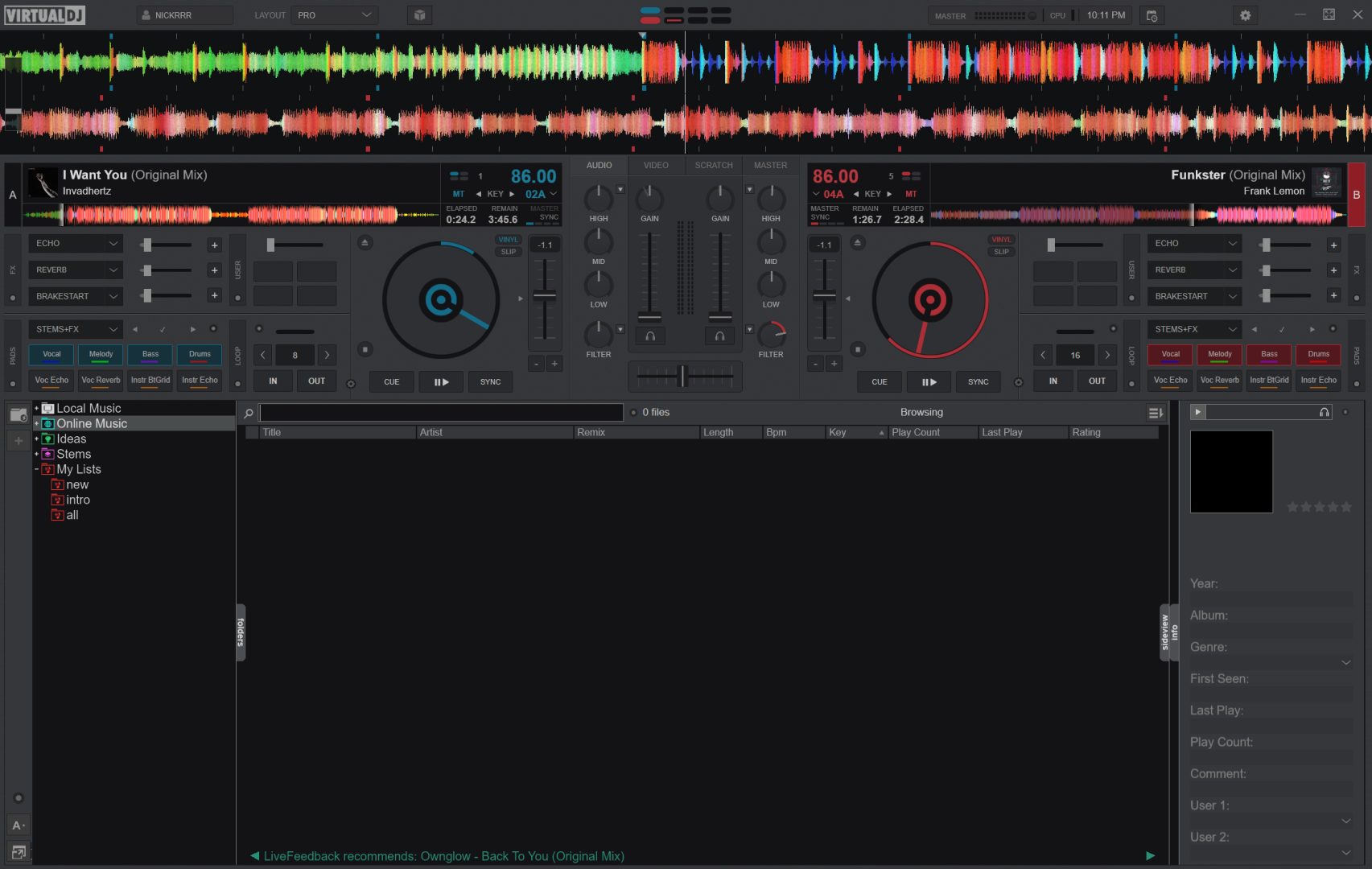

Hello I have an issue that has now occured multiple times a couple hours into a set that I am unsure the cause of or how to resolve without having to relaunch VDJ.
When playing at some point my entire library will dissapear and become unable to be interacted with
i attached a photo.
the currently loaded tracks will still work and nothing is frozen except the library which has all the songs removed and can not be expanded anymore (once closed)
i mostly stream from beatport but it does not appear to be that as the local library acts the same.
Restarting the program resolves the problem.
Thanks

Can you post the screenshot you mentioned above ?
So when this happens, the Beatport folder cannot be expanded ? Cant see you Playlists or even the default Beatport ones (Charts) ?
When you right-click on the Beatport folder, you see "sing In" or "sign out" in the menu ?
But the weird thing is that you dont see any local files either, which looks like your Hard Drive has some issue, but not sure. Your Local files are on C Drive or elsewhere ?

appologies for missing picture.
i dont really have any local files and its almost entirely streamed, but i did check and basically i couldnt interact with the library at all at this point.
whole program functions as intended still just the library completly stops working, closing vdj and relaunching fixes the problem
the laptop is essentially empty so i dont think its local storage, Perhaps something to do with playing a ton of streamed tracks or stem seperation as they both happened after 2-3 hours.

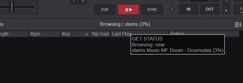

So did you also see 'Browsing' as status in the browser, and if so what did the tooltip say?
Posted Fri 25 Oct 24 @ 4:08 am
sorry posted that last commend during a set. it said something like "stem 0% trackname" from a track in my beatport playlist. and the hover tool tip i think was similar or just the song.

here are some screenshots. please advise
Posted Mon 18 Nov 24 @ 10:07 pm
it stays stuck on that, it can vary what its displaying but it makes me think its due to trying to stem seperate maybe bad tracks on beatport , or something related to browser process.
Posted Mon 18 Nov 24 @ 10:08 pm
Have you tried disabling stems in the settings?
Posted Mon 18 Nov 24 @ 10:14 pm
Is "new" a folder or list you have somewhere?
Posted Tue 19 Nov 24 @ 4:54 am

disabling stems work. ill assume its a combination of beatport library + my computers ability to proccess stems.
it would be nice for virtual dj to investigate this and find a graceful way to handle the crash.

so disabling stems prevents it most of the time but still constantly doing this. in this example i opened vdj. clicked beat port, looked thru playlist then tried closing and reopening the beatport branch in the browser tree and it got stuck browsing one of my playlist in beatport crashing the browser.
At this point i am having to consider alternative softwares as i am unsure of what i can do to prevent these issues.
