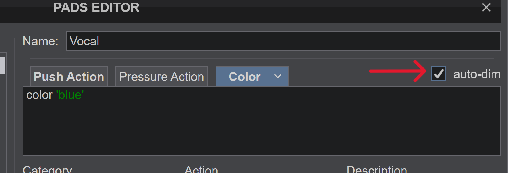

It appears you have everything set as it should be.
The one thing to check is if you have the "auto-dim" check box checked for the Stems padpage.
(if not checked, then then controllers padpages will NOT dim, so will be the same when on and off.)
Open the Pads Editor, and confirm that the "auto-dim" box is checked, on the color tab
Note: in the pads editor.. one needs to move away from a pad and back again for changes to be saved (take affect).
1) "auto-dim" is used for the stems padpage.
2) Not all padpages use "auto-dim" (others control the colors, brightness with script directly, in that same "Color" tab.
Posted Sun 01 Oct 23 @ 8:09 am
