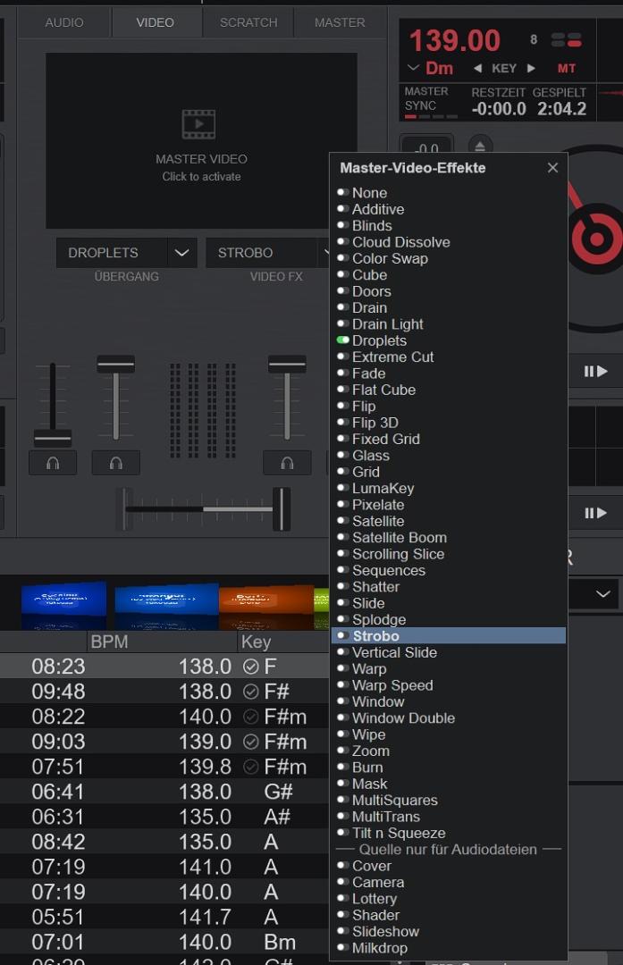

Why in the Video Panel No Video FX in the Select Dropdown by the Video FX Slot ?
There also show Transitions and no Video FX...
See Screenshot
Greetings Dani
See Screenshot
Greetings Dani

Looks like you selected the 'Strobo' transition as a video effect somehow, perhaps with a script?
Perhaps the script was meant to select the 'Strobe' video effect?
This caused the effect drop-down to show the transitions instead.
You can select a video effect again with video_fx_select "boom" for example
Posted Sat 12 Aug 23 @ 11:01 am
No in the Dropdown for Video FX I can change allready Transitions ...
See Screenshot , this Dropdown is from VideoFX Slot on Rightside ...
VideoFX not present on this List to Change
Posted Sat 12 Aug 23 @ 12:06 pm

have you checked in the "settings - extensions -fx - video fx" to see if you installed it, all fx are not installed by default
Posted Sat 12 Aug 23 @ 3:25 pm
All Installed..
Sure.
Otherwise I wouldn't say it.
See Screenshot , by Video FX Slot Dropdown for Select Video FX , there Transitions , not Video FX
Sure.
Posted Sat 12 Aug 23 @ 4:38 pm
Like I said, you need to use a script to select a video effect again, so that the drop-down will no longer show transitions instead
Posted Sat 12 Aug 23 @ 4:43 pm
How I write .
I have open the Dropdown in the Master Video Panel with ma Mouse , not Controller ...
In the Player it works normal .
But not in the Video Panel .
Left Transitions , and Right also Transition , but normal must Right Video FX and not Transitions to Change ...
See the Screenshot ... All other works , only this Dropdown .
Its default Skin ..... And all others also the same ..
Posted Sat 12 Aug 23 @ 6:43 pm

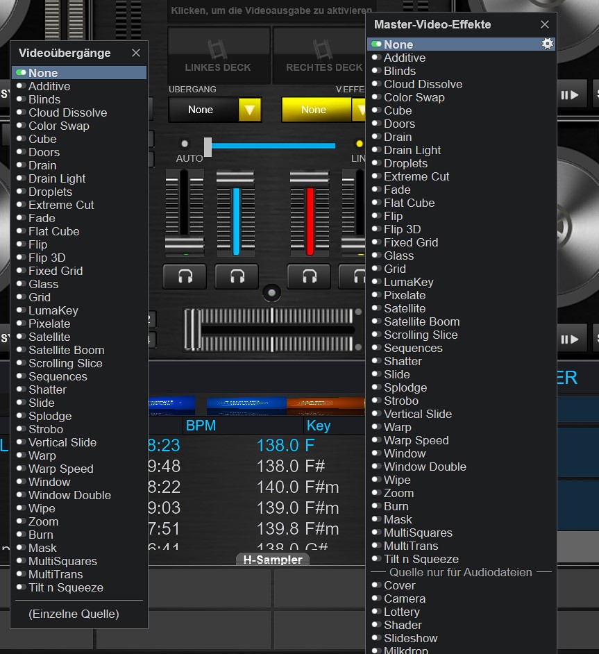

You can write video_fx_select "boom" in a custom button, after using it it should be fine
Posted Sat 12 Aug 23 @ 6:55 pm
I'll explain again.
On the left is the slot for selecting transitions.
Correct ?
And on the left the video effects slot. (This should also be there to load video effects into this slot, so if I click there with the mouse, the dropdown opens and I select an effect).
Now, when I click on it with the mouse, and the dropdown menu opens, it only shows me transitions, no video effects to choose from in the list.
So , and again , it 's the same with the default skin , and with all other skins . And nothing was changed on the skin.
I even tried downloading and installing an older version, up to the last one with 2023 new stems, but there too.
And one more thing , the video effects are all installed , and in the Deck Player FX slots they can also be selected using the Select drop - down . Even if I completely empty all slots, alao None FX, then nothing changes. All other effect slots work normally as usual, from master effect to deck effect, except for the video effect slot.
Posted Sat 12 Aug 23 @ 8:27 pm
just do as he says, it should clear the bug
Posted Sat 12 Aug 23 @ 8:37 pm

Here is another screenshot.
You can still see it clearly there.
On the left at Transition it opens the Transition Select context menu.
And on the right where video effects should actually be selectable, he also opens the transition menu.
Both clicked with the mouse.
Try it yourself, it can't be that it's just me with the error.
Posted Sat 12 Aug 23 @ 10:43 pm
