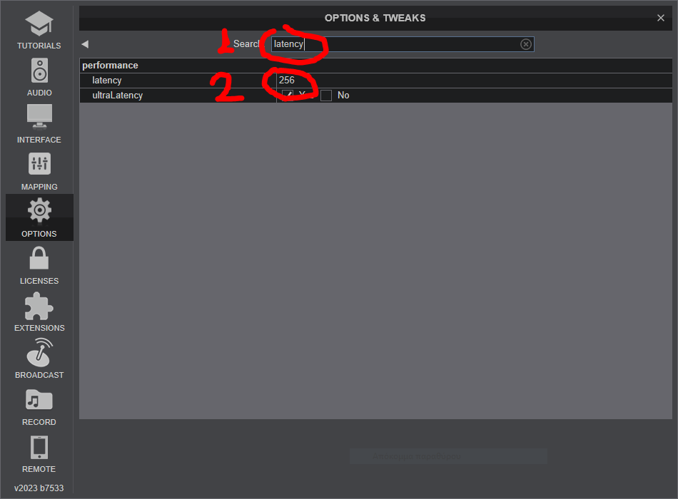

Before anyone hounds me for my controller choice, I know it's not a full feature option but it fit my wedding DJ needs at this time and fit my starter budget. :)
Purchased in December but haven't had many gigs until just recently as it's been slow where I am. When controller is hooked to Mac and audio out of controller, I am getting a popping in the audio. I contacted Numark and they mentioned buffer settings but only how to adjust in Serato. I haven't been able to find it on VDJ.

Check the latency setting in VDJ. I use my one at 512 (in Windows) and it's fine.

That’s where I am. Can’t find where to change or adjust.

What number is recommended? Mine was in ZERO.
I also don’t have the ultra option like the screenshot.

As I said above 512 works fine.

Well, I've tried to adjust the latency and still pops. Any other ideas? I have it at 512 currently.
