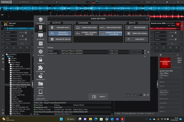

5, Checked my settings are correct which I think they are as per the image below

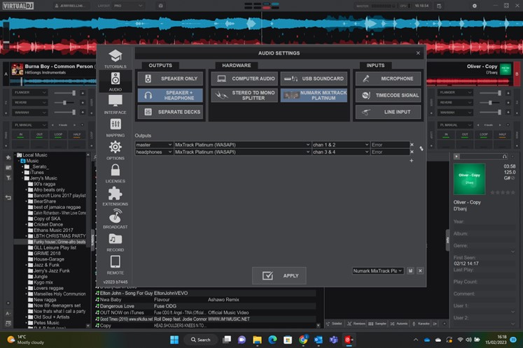

Your outputs say "ERROR" this is a problem of the audio driver from the Mixtrack. Why do you use WASAPI? is there no ASIO for the Mixtrack?

I hve fixed the error on the outputs...
I'm don't have any other option other than WASPI, or I am not technical enough to understand how to change it...thank you for replying
