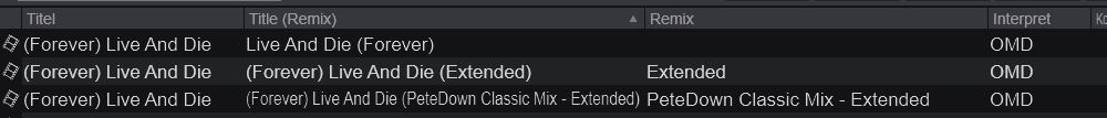

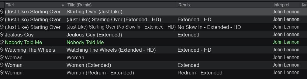

In VDJs browser I use normally the combined field "Title (Remix)" for displaying the information, but take a look:
The tags are all the same, but take a look, what VDJ does in the first line! I have here also activated the normal "Title" and "Remix" to show the original values.
Same here ...
... but if we think that this happens only in the first line of the list, so just switch the sort order. It seems, that VDJ does something with the results of the search and the first entry of this result list is wrong. If I put something in the subtitle/remix fiels like "xyz", the value of "Title (Remix)" ist displayed correctly.

The "Title (Remix)" column checks both the title and the remix field in the database to determine what the title is and what the remix is. (Similar to what happens when the title and remix are displayed on the deck)
In some cases this could indeed incorrectly detect some part between brackets as the remix.
