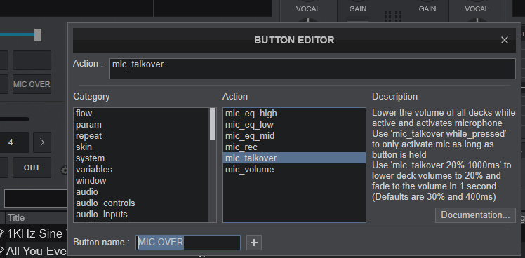

For a Mic Talkover function, create a Custom button ...
