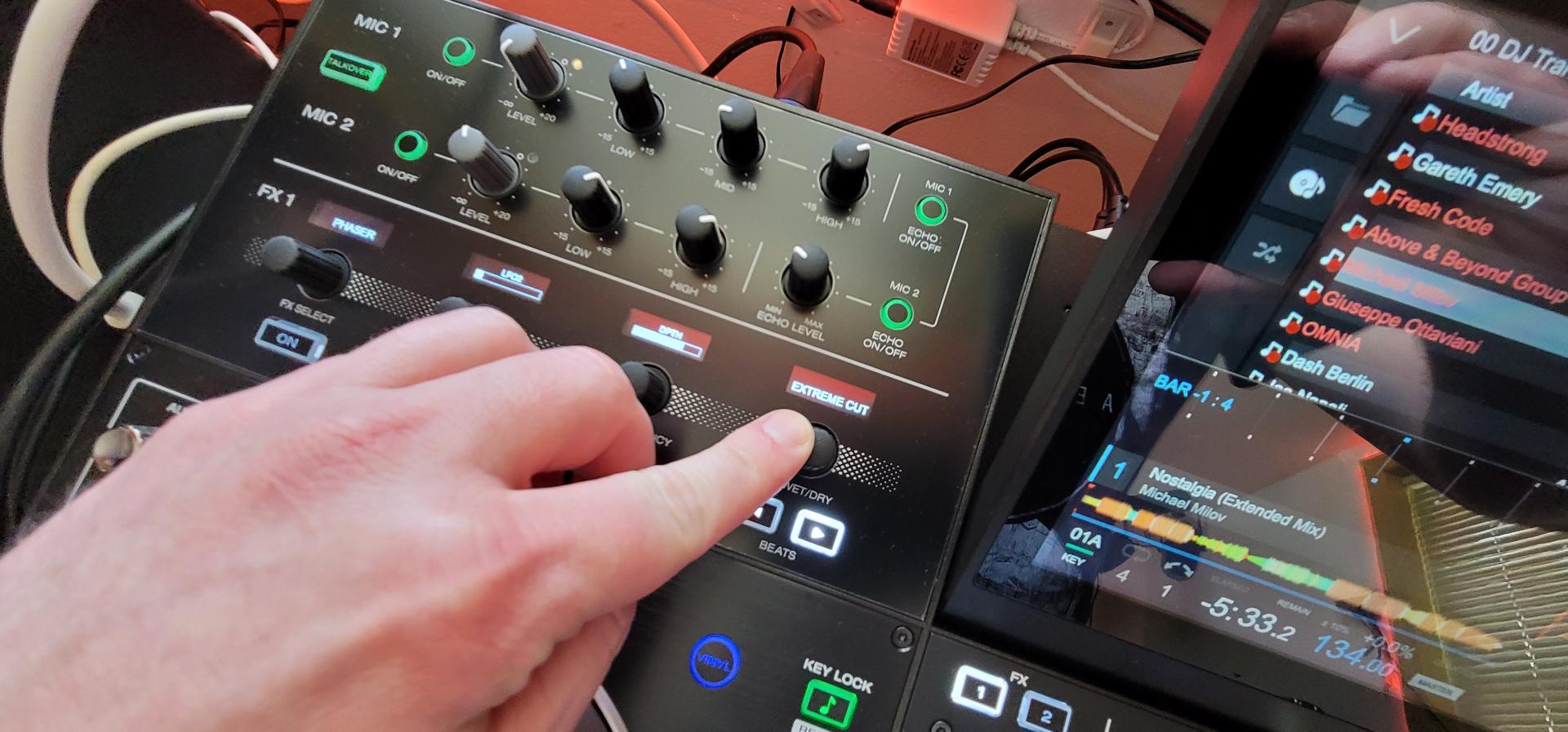

Been using the Prime for for a bit with VDJ for my video gigs, no issues. Out of nowhere, if I need a shift function, the board becomes useless unless I reboot the board... Nothing changed when this started.. So since then I made sure firmware was updated, VDJ running the latest public build, same issue. Only happens with Virtual DJ and no other software or in stand alone mode.. Other users in another form have reported the same issue. Im using a Mac with Majave OS 10.14 (the latest my Mac will take) . Tested with Serato, no issues at all, same in Standalone mode.. See video for a demonstration of this issue

So I tested it again and all you have to do is hit shift on the prime and it's done. You can still DJ just like you see in the video the best way I describe it is the buttons on the prime stop indicating their state as well as the VU metres. Everything still functions but your flying blind.
Posted Tue 13 Apr 21 @ 3:48 pm
New update, the shift on the left deck is the only button that causes this freeze up

Found the issue I'm pretty sure.. On the deck you can control the video transition effects.... It was set to Extreme cut and so far everytime I set it to extream cut then hit the left Shift.. Bam.. It happens... I'll be testing this even further and report back
Posted Tue 13 Apr 21 @ 6:48 pm
Confirmed.. When this is set to Extreme Cut.. The problem occurs
Posted Tue 13 Apr 21 @ 6:54 pm
Just tried on mine and not getting the same result. Extreme cut selected. Press left shift. Works OK here.
Posted Tue 13 Apr 21 @ 7:05 pm
Yeah that's weird, so for now I'm just not going to use that transition not that I ever really do they must have got bumped I usually use droplets or fade or something like that.. also not sure if you're using a Mac or Windows
Posted Tue 13 Apr 21 @ 7:08 pm
I'm Windows so could be a thing with Mac version of that effect.
Posted Tue 13 Apr 21 @ 7:17 pm
Yes.. For now I will make sure not to use the extreme cut effect.. I never do anyhow but did not realize it was bumped over to that
