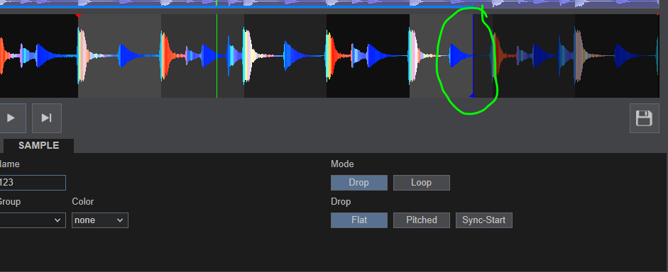

I noticed that my sampler isn't playing my drops all the way through, but stops before the end, is there a setting that is causing this ?, using the latest vdj 2021. Thanks.

The drops set as loop perhaps?
Open them in the Samper Editor, and see there

Check that, they are all set to drop / flat in sample editor.

Odd,.... check at the far right in the waveform in the Sampler Editor.
Should be an end marker (blue line). Perhaps its not all the way to end?
If it is all the way to end, perhaps something happened when you created the sample? recorded a loop that didnt catch the full length you intended .. not sure

The blue start and end line is at the start and end in the sample editor. The other thing which is a little from the norm is im playing files using isrepeat ? nothing : sampler_volume_master 65% & sampler_play_stutter "T:\RandSample\5DFyffe.mp3"
