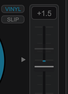

In case it is a clue, I also get a faded 'shadow' pitch slider in the GUI:
This is with the pitch going up to 8 and down to -7.4% (after a small wait for DVS to readust).

My guess is the shadow pitch fader was the left over MIDI signalled pitch setting, left there after I deleted the `pitch` midi mapping - it doesn't appear now.

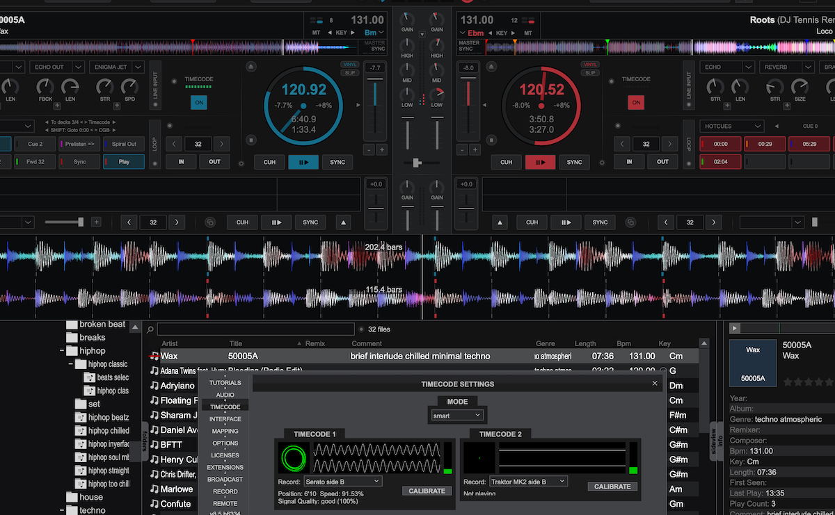

(When I take a screenshot the pitch goes down to -7.7% for the first time in days of testing this! But deck 1 is playing at a fraction slower than -8%, and has been for several minutes. Deck 1 BPM is definitely between 120.45 and 120.55 as the tunes are locked in sync and again, has been for minutes, but the GUI has stuck on 120.92.)
