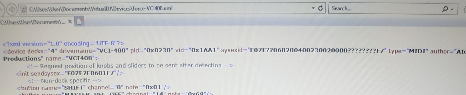

I'm the guy trying to get his 3900s to work with his vci400 which has a custom device definition so I have to disable built-in device definitions for the custom files for the vci-400 to work but then the 3900s don't work. I've tried "Force -" command but it's not working. So I figured if I could put the device definition . Xml for the 3900s in the devices folder then when I disable built in definitions it'll be able to see the 3900s xml. I hope I'm being clear cause that has been driving me crazy.

It's not working for me
Posted Mon 29 Mar 21 @ 6:20 am
So you have a definition in your VirtualDJ\Devices folder (not mappers folder) called "force-VCI400.xml" or something like that?
Posted Mon 29 Mar 21 @ 6:46 am
Yes

What is the first line of your definition to identify the device?

Posted Mon 29 Mar 21 @ 7:27 am
Your PID seems to be wrong.
It should be pid="0x0231"
Can you change it and try again ?

That seems to have worked. I'll be testing indepth later tonight.
