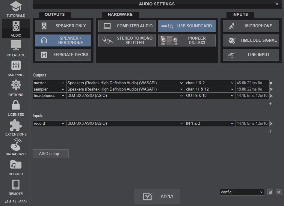

I'm not entirely sure what I'm doing wrong here. I have my DDJ-SX3 hooked up to my desktop PC with the USB cable. I have the master and sampler audio set to my computer speakers, audio comes through fine on them. My headphones are set to the DDJ-SX3, they get audio fine plugged into the headphone jack on the DDJ-SX3.
When I start a broadcast to a shoutcast server, it hooks up to the stream, and sets the "Playing Now" as expected on the streaming site. But no audio comes through at all. No audio gets recorded if I try recording instead of broadcasting, either.
(I've tried setting up the audio with the 4 decks instead of just the master too, that didn't seem to make a difference for broadcasting. I also had a more complicated setup funneling the audio from Virtual DJ through Voicemeeter Banana and Broadcast Using This Tool, which did stream to the shoutcast server correctly. But I'm trying to simplify and get rid of Voicemeeter and B.U.T.T., and broadcast directly from Virtual DJ now)

Remove the record line

That was easy, that fixed it. Heh, thanks so much!
