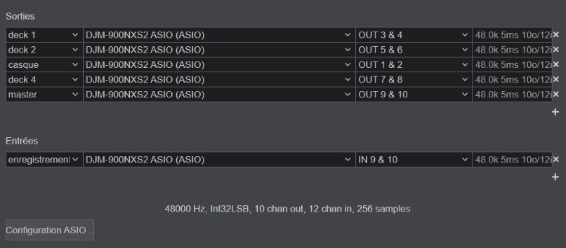

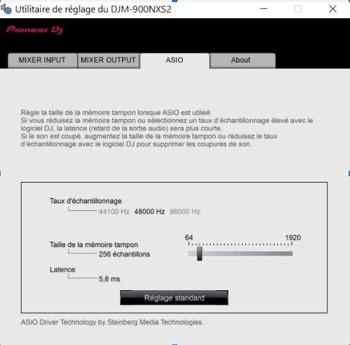

          Hello,
here are my settings:
but with this ASIO i usually set the buffer value around 1024minimum to avoid noises when the CPU is stressed (i usually broadcast video when i play).
FYI, i have played this week using my XDJ-XZ material and i have the same issue. The ASIO driver is better than DJM ASIO and can be set to 256 without noises, but when i use buttons to start the sampler, i have much difficulties to sync the sampler with the tempo.
So having a possibility to add a marker in the sample that identifies the main beat to be in sync with the tempo would be a great feature.
Thanks
