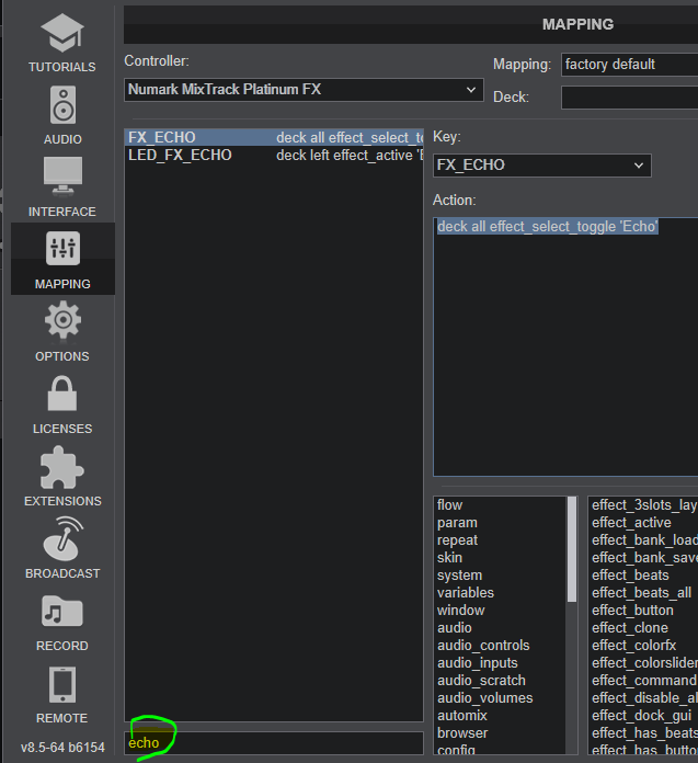

I have the Numark Platinum Fx with the paddles. I would like to remap the echo button to another echo (vst?) that I want to use? can anyone help me with this? please? and thank you..

Can usually almost map anything on a controller...
The Platinum FX controller has 6 quick select effect buttons middle of the controller, where echo is one.
Just search echo in the mapper settings (bottom left corner), and change the action script there.
The default is mapped to : deck all effect_select_toggle 'Echo'
To set to other VirtualDJ effect, simply change 'Echo' to the name of other effect you want to use, including any name of a VST effect you might have added.
Remember to change same for LED_FX_ECHO so that the light also works on the button ;-)
