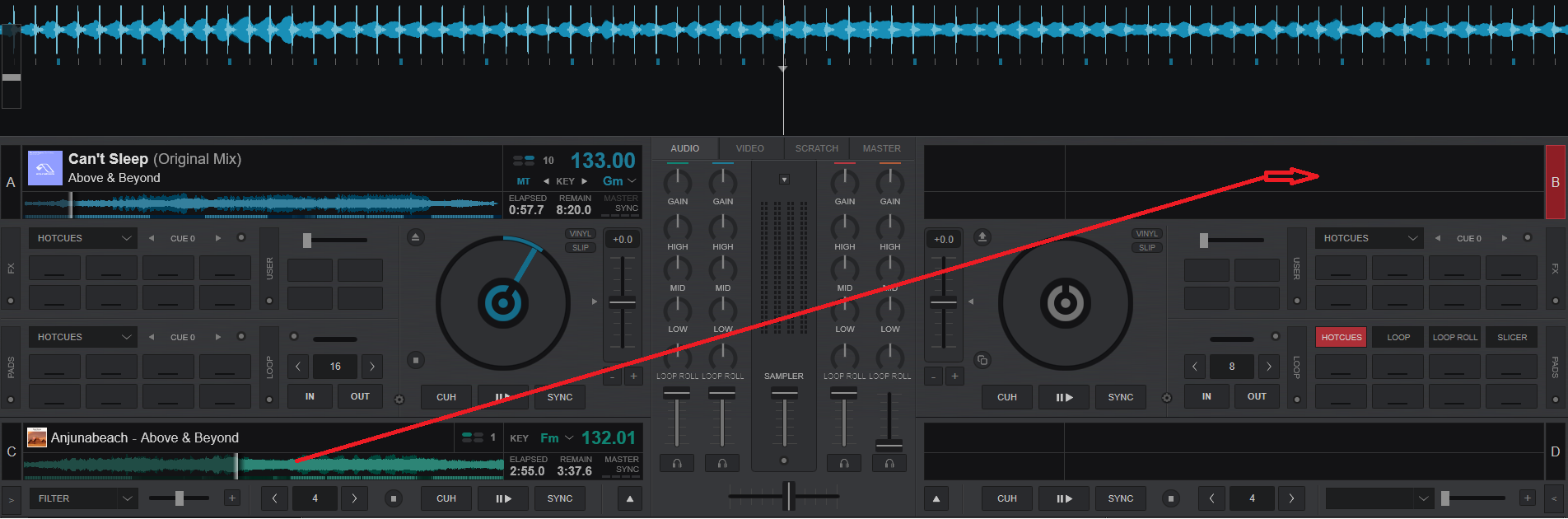

I have a single SC6000, and I'm trying to use its dual-layer capability to control decks A + B, so I can get the two wave-forms to beat-match, etc.
By default, The deck selector gives me only A + C or B + D. This is a problem, because choosing the layers is only swapping decks on the same side of Virtual DJ.
Is there a way to get Virtual DJ to show the SC6000 decks 1A and 1B in the A and B decks? I've tried ever setting I could think of, and couldn't get it to work.

I have the single SC6000 and the x1850 mixer. When I click the Layer button it goes from A to C (if I tap), or if I hold it down, it will switch to B + D (when I tap).
This in itself isn't an issue, it's that I can't seem to swap the deck letters in Virtual DJ, which seems like something you should be able to do. But I'm new, so I'm just guessing.

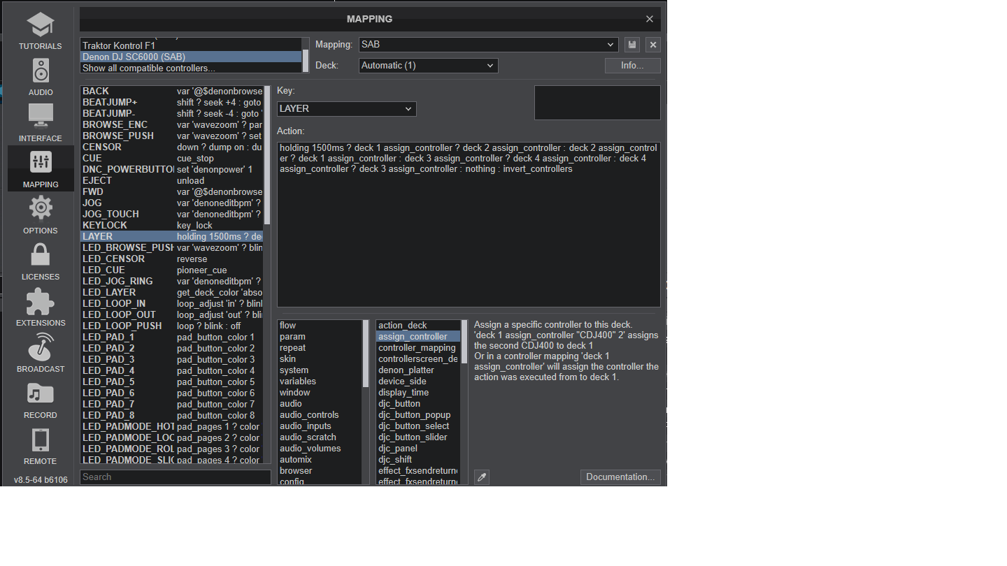

I did find this in the Mapping settings under LAYER:
holding 1500ms ? deck 1 assign_controller ? deck 2 assign_controller : deck 2 assign_controller ? deck 1 assign_controller : deck 3 assign_controller ? deck 4 assign_controller : deck 4 assign_controller ? deck 3 assign_controller : nothing : invert_controllers
Maybe this needs to be changed somehow?
Also, with 4 decks selected, I still have to hold down the Layer button for several seconds to flip over to the B + D side, so it's still not a good solution. If I just had to tap-tap to get to the other deck I might learn to live with that.

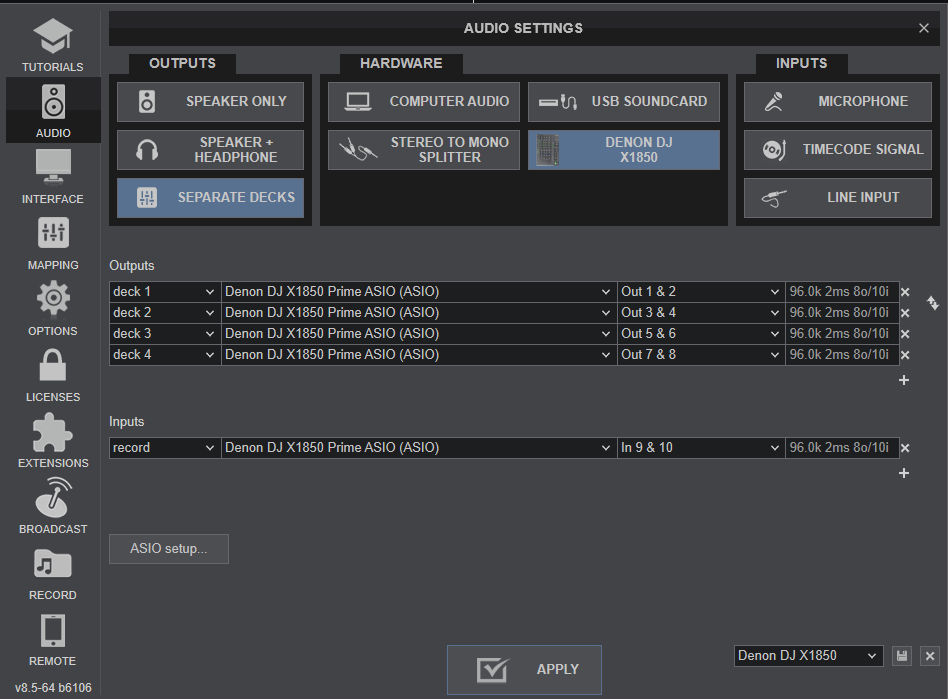

Screenshot 2 is my Audio Setup
Screenshot 3 is what I need: My second layer to be assignable to the B deck, so I can work with the wave-forms.

Did u try the action i wrote above for the LAYER button ?

DJDad, I'm an idiot. I missed the bit of code you posted, which does indeed work! Thank you so much!
