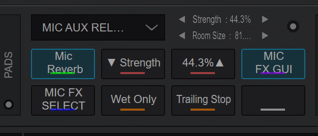

Would this new plugin Mic Aux Release Sampler FXs MARS (added a few days ago, 10-18-20) by Nicotux provide an easy solution to adding affects to your mic.
http://www.virtualdj.com/plugins/index.html?addonid=81094
No need to run mic as line in on a deck to get effects and have full control of them.
I find this Plugin amazing and so easy to use on the pads.
