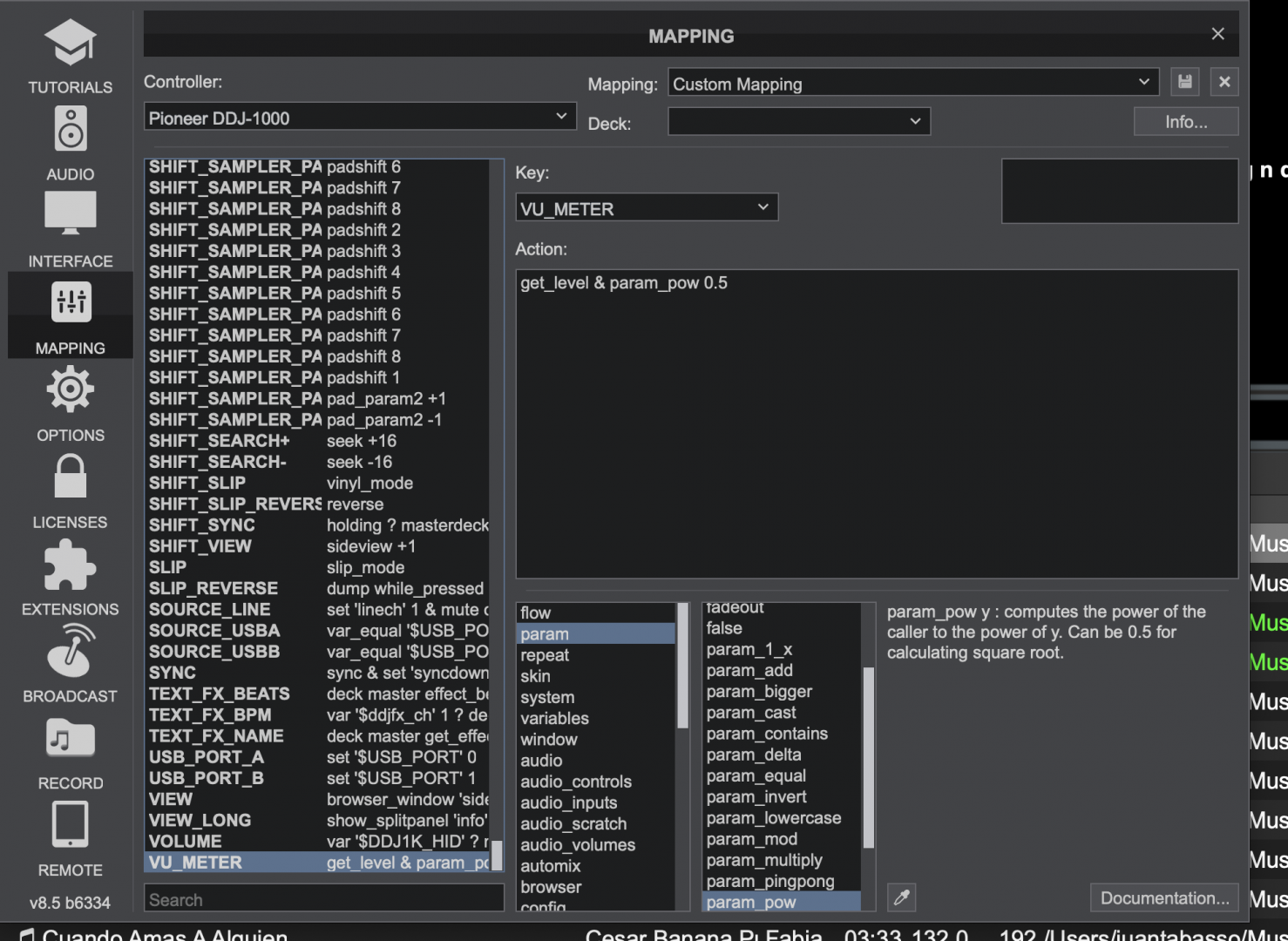

For DDJ-1000, on the led deck vu meter : one led is 3 dB/3 dB per led
so in the factory default script there is a bug :
<map value="VU_METER" action="get_level" />
(1dB per led)
And should be :
<map value="VU_METER" action="get_level & param_pow 0.5" />
-> one led : 3 dB, ok
Please fix this in default DDJ-1000 factory default, and with this parameter, DDJ-1000 deck_meter works better in VDJ than Rekordbox 5.x/5.5, because Rekordbox 5.x/5.5 have a +6dB bug (It display +6dB more on deck level meter on DDJ1000, than Rekordbox internal display and the real Headroom/audio...)
Regards,
Olivier F.
(1dB per led)
And should be :
Regards,
Olivier F.

Dear Phantom,
You answered to quickly.
i've never say that : "VirtualDJ doesn't not show the headroom on VU's, or are wrong in dBfs....."
And i don't speak about Master level VU-METER, but deck(1/2/3/4) level meter of DDJ1000.
I don't think in analogue mode.... you take me for a stupid man :
With VDJ GET-LEVEL only, level meterod DDJ1000 don't behave like Rekordbox:
at -9 dBfs :
0 green led on / the 8 others off
at -8/-7/-6 dBfs :
1 green led on / the 8 others off
et - 5dBfs :
2 green led on / the 7 others off
at -9 dBfs :
at -8/-7/-6 dBfs :
et - 5dBfs :
Posted Sun 21 Apr 19 @ 9:02 pm
Dear Phantom,
With VDJ GET-LEVEL only, level meter of DDJ1000 don't behave like Rekordbox:
at -9 dBfs :
0 green led on / the 9 others off
at -8/-7/-6 dBfs :
at - 5dBfs :
at - 4dBfs :
4 green led on / the 5 others off
at - 3dBfs :
4 green led on/ 1 yellow on / the 4 others off
at - 2dBfs :
4 green led on/ 3 yellow on / the 2 others off
at -1dBfs :
4 green led on/ 3 yellow on / 1red on / the 1 others off
at 0dBfs :
4 green led on/ 3 yellow on / 2red on
So VDJ dBFS ok, but display scaling completly different than Rekordbox with DDJ1000....
Just what i said....
And with this soluce :
-> The display deck level meter on DDJ1000, behave like Rekordbox without the +6dBfs Rekordbox bug, soon fixed.
Thanks
at -9 dBfs :
at -8/-7/-6 dBfs :
at - 5dBfs :
at - 4dBfs :
at - 3dBfs :
at - 2dBfs :
at -1dBfs :
at 0dBfs :
Thanks
Posted Sun 21 Apr 19 @ 10:08 pm

Thank you olivierbergman I have changed and with the values you set and it works!

Thanks, that was the setting I was looking for.
Before I was using auto gain to get the VU meters going.
Now this is no longer needed. :)
