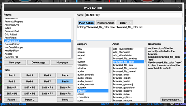

I created my own Pad Page with colours for my own use.My colouring system is for the type of genre the track is; e.g. Blue is for good dance tracks, Purple for RnB, Red for DO NOT PLAY due to profanity at certain types of venue i.e. weddings, etc.
This is a pad page example. You can highlight a single track or a group of tracks and change their colour instantly;

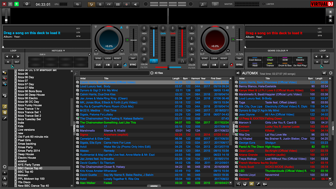

This is the result, centre browser is the current BBC Dance Top 40, in the right Automix window is the current BBC Top 40;

          All the info you need is there in the post above, with the exception the button colour and that is as simple as
color 'red'
