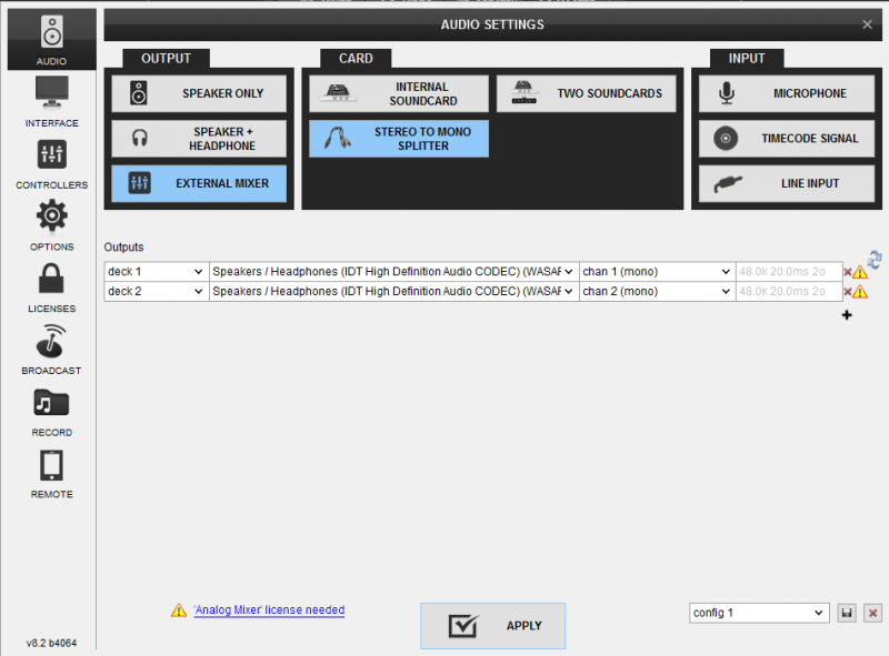

I am using VDJ 8, with no licenses or controllers at all. If I am connecting to just a basic analog mixer or digital audio interface, do I still need a mixer license? In other words, do I need the AML regardless, if I connect to any outside source- mixer, audio interface or controller?
And if I get the license, how do I configure it in settings?

If you use it at home, and just include the mixed output from VDJ on 1 channel, then no
But if you setup VDJ to use external mixer mode, so that you can do the mixing between the decks on the mixer, then yes
In that case you also need a way to get 2 separate outputs from VDJ
One way is to get a multi-output soundcard
Another way is to use a splitter cable, and use 2x mono output
The setup for the "mono way" is shown in the image below, where you can also see it says that you need the analog mixer license
