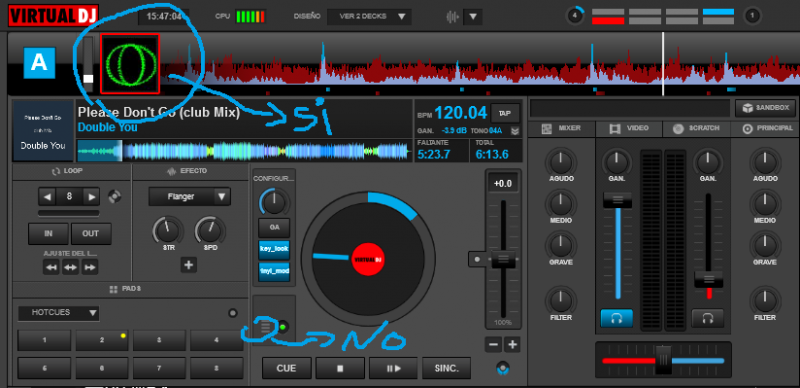

Hi, I need help to add the Skin to the Visual TimeCode Operation. please any idea of ​​the Code of Visualization? some custom any Get_timeCode visual?

I have not found a Skin with that Code. :(
but I think that if you could because other software if they show this graphic, and Virtual Dj 8 also shows it but only from the configuration in the Tiemcode tab.
I need to put it inside the skin to be able to see Check if the pua is reading good or is dirty.

:( I Need de Circle Live Reading.

I see now that the timecode circle is only displayed in the config window. It's not part of the skin code (because it's for setting up only and is not needed all the time), so I don't think it's possible to display that on a skin.

The get_timecode_quality returns just a percentage % not any graphics. So what you ask is not available. The Timecode quality graphics is only available inside the TC Config panel and really not sure how this can be useful to see on a skin while performing

Thank you two for responding. If it is useful to me since that could detect if the needle is clean or with dust, lint, dirty, since I usually happen that during a mix between 3 or 4 songs the needle usually accumulate dirt and begins to read with error or Also to detect any voltage fault in the cables that transmits them to the other deck and therefore affect the speed of picht of the other deck. this also happened to me
