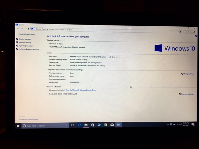

I Have Two Laptops..
ASUS Laptop works fine

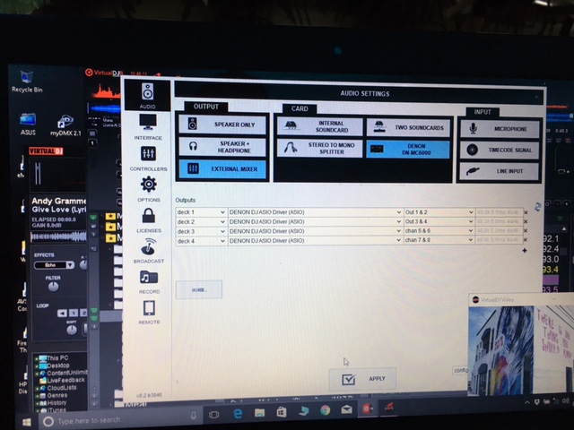

The HP Does Not...Using Asio Because WASAPA Wont Work For Some Reason With The HP Laptop & DN-MC6000 Soundcard
I've Updated And Tried All Combinations For The Sound Card....

I think that Denon never really got the ASIO drivers to work perfectly for the first generation of the MC6000 (mk1)
For as long as I can remember there has been reported issues with those drivers on this forum, and the simple fix was often to switch to WASAPI
Do you know more about why you can't get WASAPI to work on your HP?
Because if you are running into problems with the Denon ASIO driver on your specific laptop (it doesn't happen for everybody) I don't think there i much help to get from Denon anymore

I never had any problems with the Denon MC6000 ASIO driver in over 5 years of using it.
I switched last year to the MC6000 MK2 which has a different driver, again no problems.
Iirc there were 32bit and 64bit versions of the original MC6000 ASIO driver, just have to make sure you have the right one.

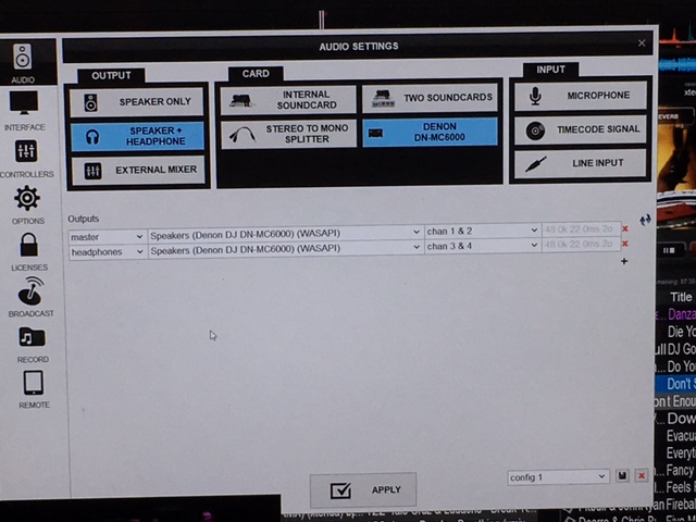

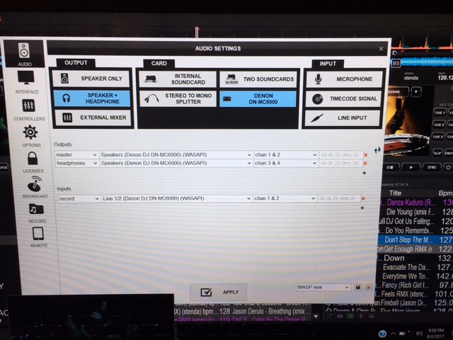

The WASAPI works LEFT SIDE ONLY
deck 1 Speakers Denon DJ DN-MC6000 (WASAPI)
deck 2 Speakers Denon DJ DN-MC6000 (WASAPI)

I got the Wasapi to work! Will test Tue at gig...I had to delete the Denon ASIO Control (Audio)
