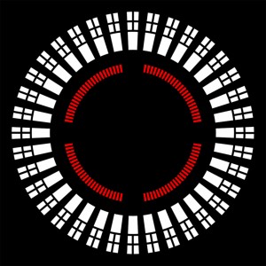

I bought a DDJ SX2 and after my mapping, on Thing doesnt work.
The Controller has inside die jogwheel a red LED-"4-part"-wheel.
Standard it flashs only when i scratch.
Now, im am searching the command, that the LED is always on.
What could i do?
What could i do?

This "led" is a Hardware indication that the platter is pressed and its not part of the MIDI, so cant be mapped/controlled.

Really? Because i think the Name is innerjogwheel and it´s mapped in the Standard, too?!
Posted Thu 10 Aug 17 @ 1:44 pm
I mean this:
Posted Thu 10 Aug 17 @ 1:46 pm
LED_JOG_INNER
That's the key you need to remap
